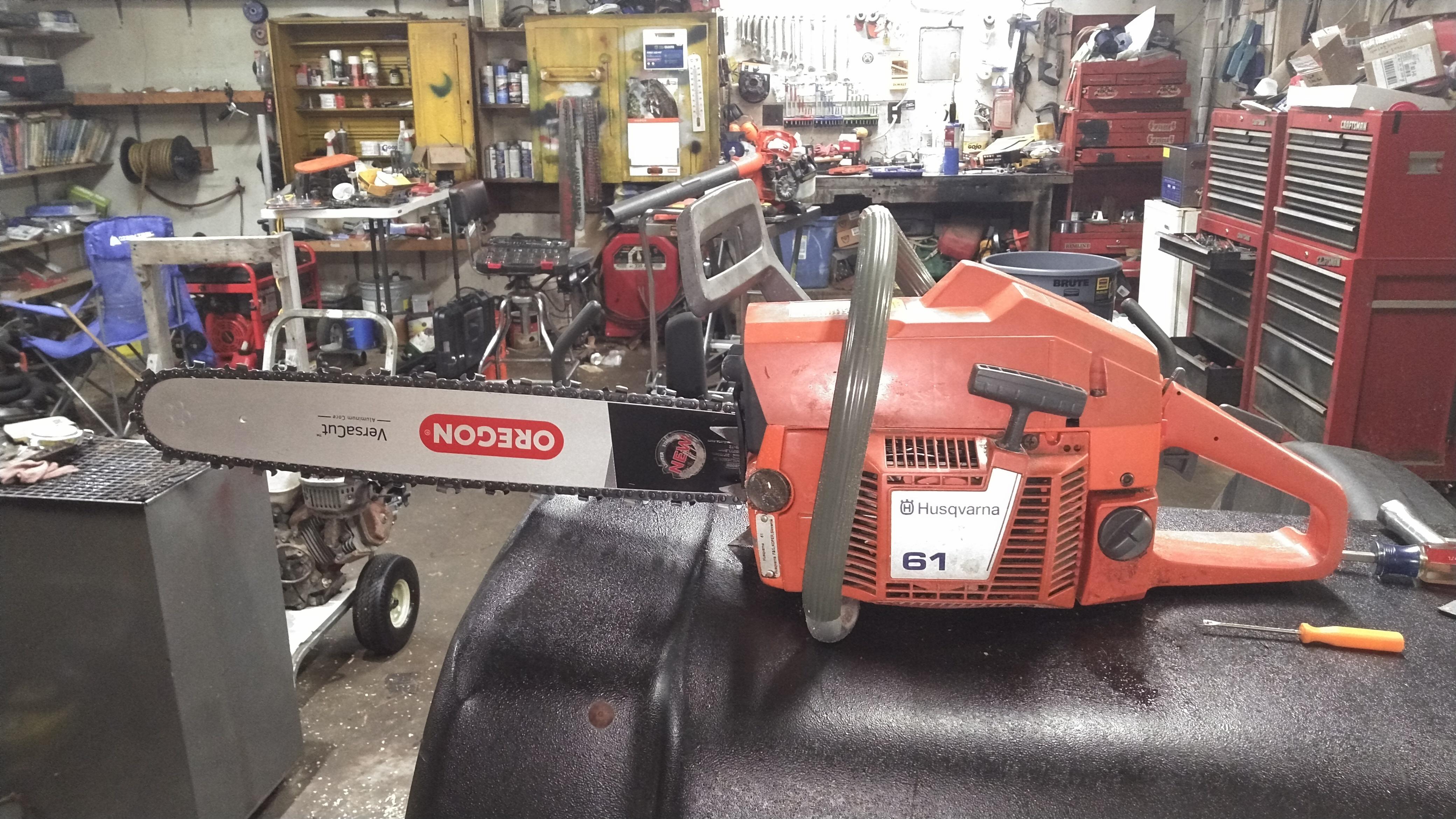

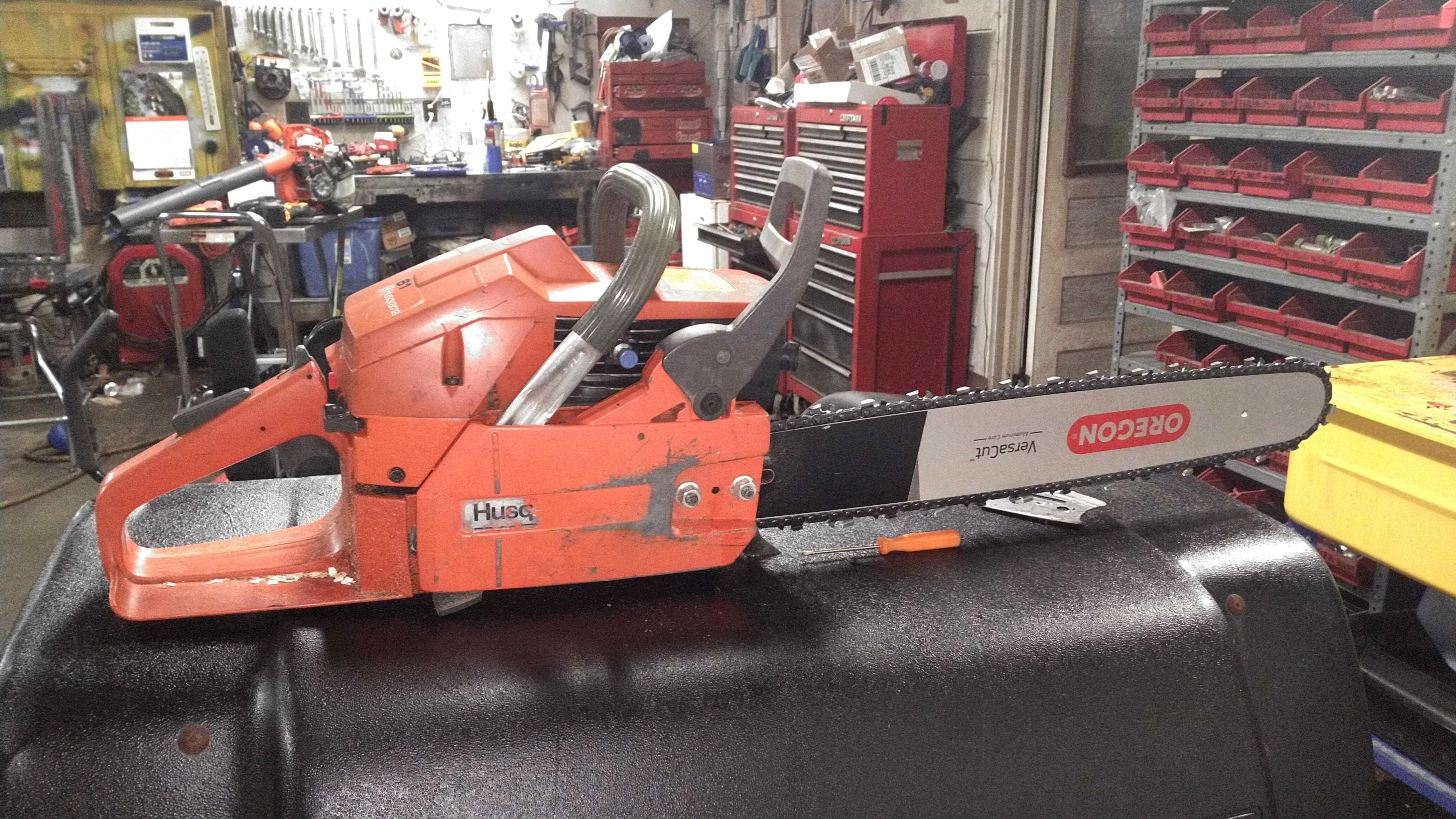

My 61/272XP conversion eating! Hyway cylinder and popup piston, running a base gasket. eBay dual port muffler. 20" VersaCut bar, 3/8 .050 EXL chain. 7 tooth spur. Still a bit fat for breakin.

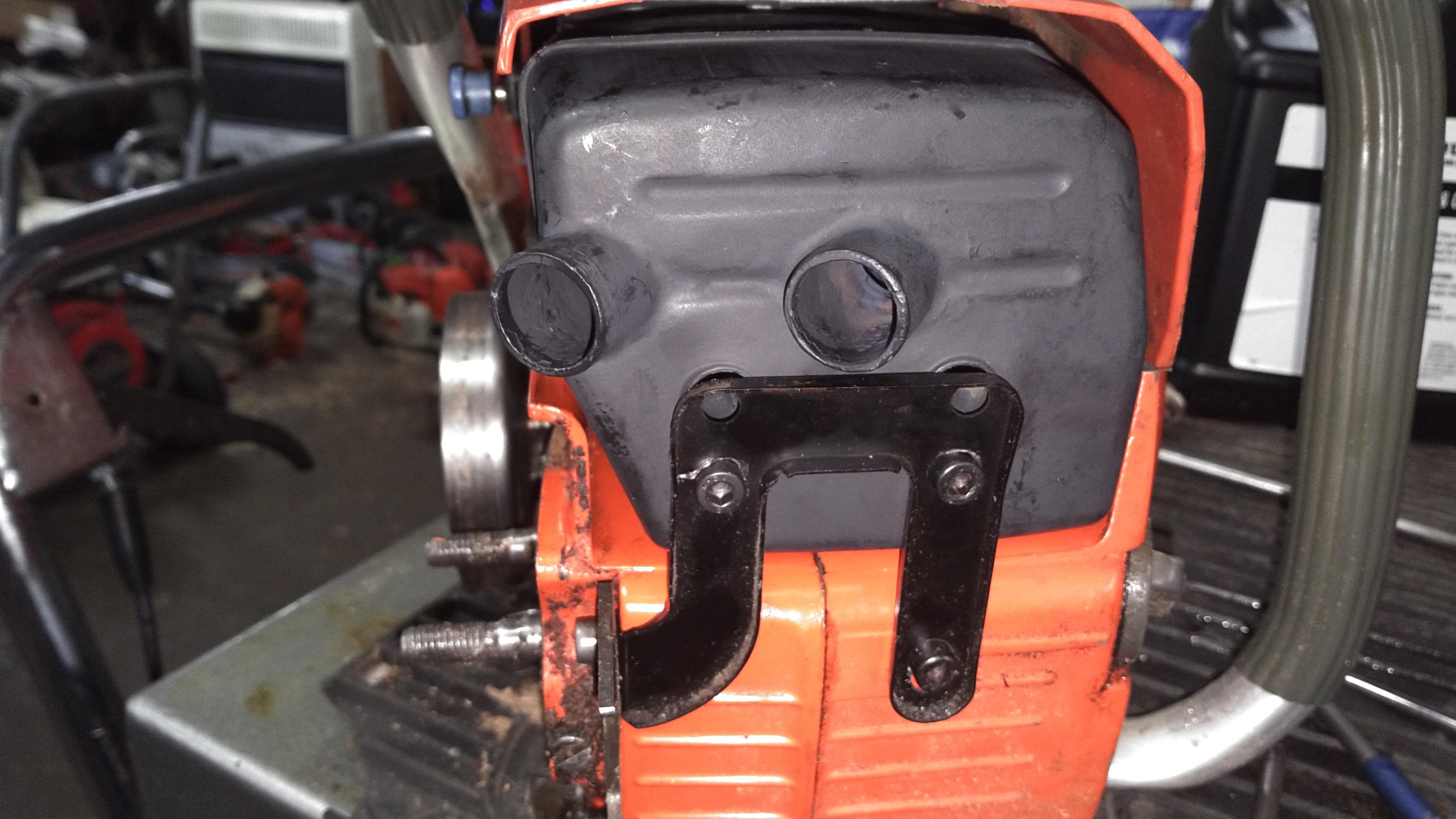

What's the reason for this piece on the front of the 365 muffler, is it to dissipate heat?
