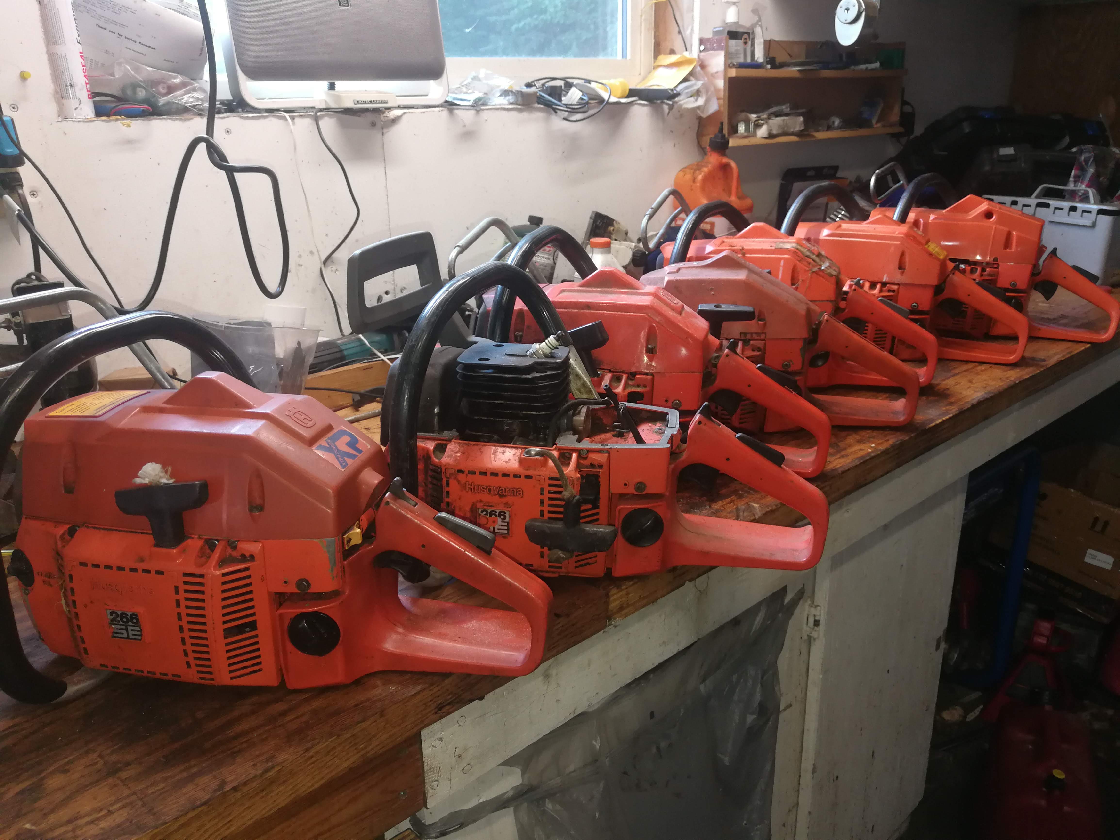

The way to tell the coil without having the saw in hand is the front top cover bolt. Dual coil, it's in front of the recoil bolt, single it's behind, compare this 266 to those 61's and you will see what I mean

The single coil 61's use the same cover bolt pattern as the 268/272 and have the taller muffler, so can be easily converted to a 272 clone. The dual coil ones used the 266 pattern so are not directly interchangeable.
IIRC some of these also came in grey top with the newer front bolt placement.
I believe they also have the larger venturi carb and better performing cylinders than their predecessors.

I don't actually have a 61 top cover here, both of my 61 chassis are dual coil, but the 272 top end does fit under a 266 cover. I've built a couple of them now, keeping the 266 muffler.

Yah, I think all but the earlier 61 covers will clear with a 272 cyl.
By 'clone', I mean all the 272 parts go on, with top cover compatibility the whole muffler and intake system can go along with it.
I've heard that some of the two piece ign saws had enough extra material to drill/tap a hole for the newer covers but I haven't run into one myself.
