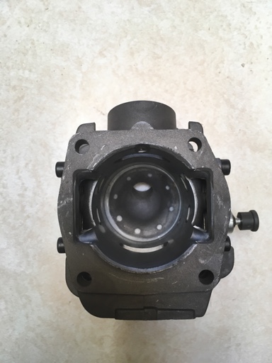

Husky 345 big bore kit question:
Which orientation of the riser block is correct?
#1
#2
67L36Driver
7:27 PM
596
9,675
41,659
Never done one but wouldn’t you look at the transfer port orientation on the cylinder as installed and match the spacer up with that?
Nothing that would indicate.
Edit:
Just discovered the bolt pattern only lines up one way.
[emoji849]
