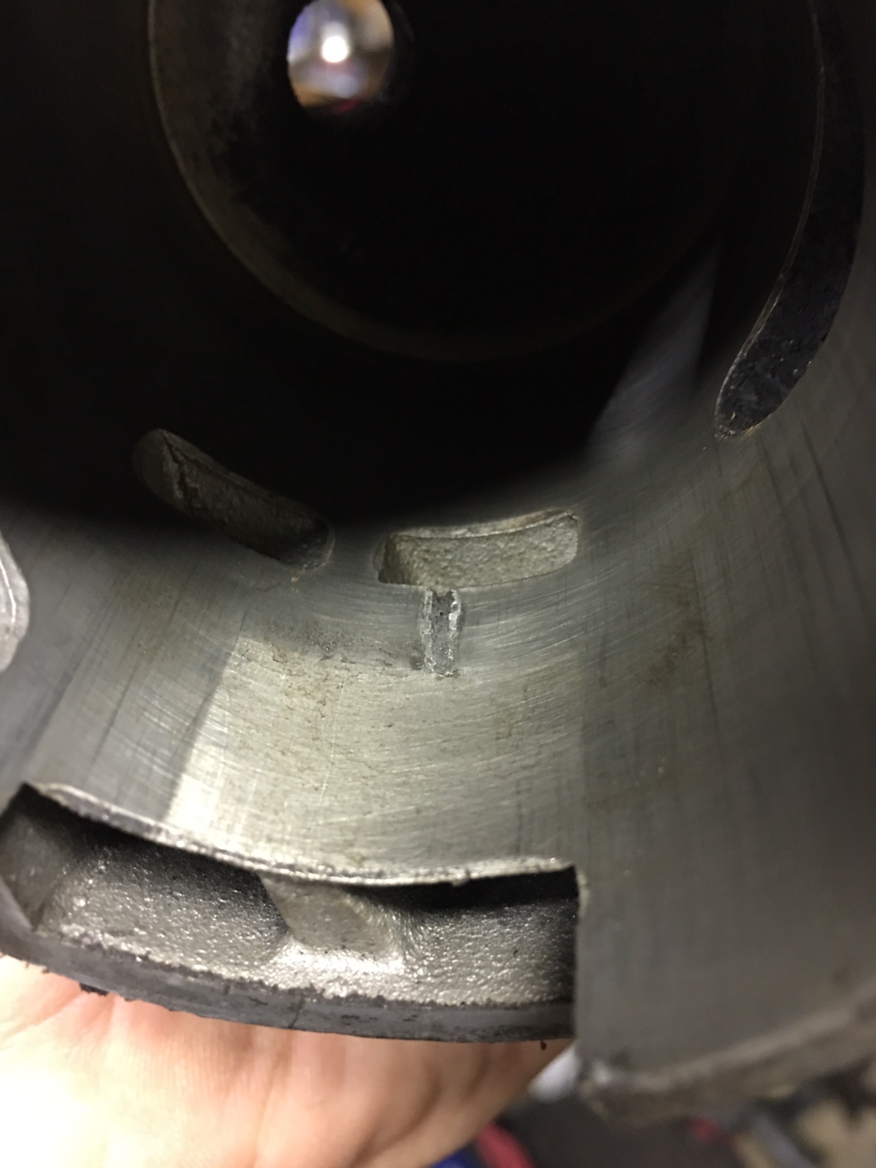

This is a 390 cylinder from a saw that was locked up. I believe the pto side crank bearing let go and a piece of it did this. After I replace the bearings and seals, would y’all clean this up and run it or replace it. It’s a pretty good gouge but I’ve never dealt with a defect in this area before. You can imagine my surprise when I pulled the muffler and there wasn’t a single score mark to be seen. TIA!
