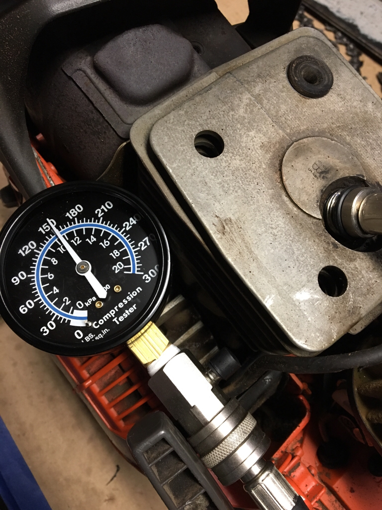

One more question...what would you guys do with the saw above? Holds vac and pressure fine, just checked compression and it's north of 150#...saw runs well. Would you tear it down and repair/replace p/c or run it?

You could be fine but I couldn't let that go without taking a look to see if there's even the slightest bit of transfer.
Then while you're in there might as well lightly scotchbrite the cylinder and throw on new cabers.
Then might as well check squish and maybe delete the base gasket.
And while you're there trim a bit off the intake side piston skirt and then on to the exhaust and transfers and then...

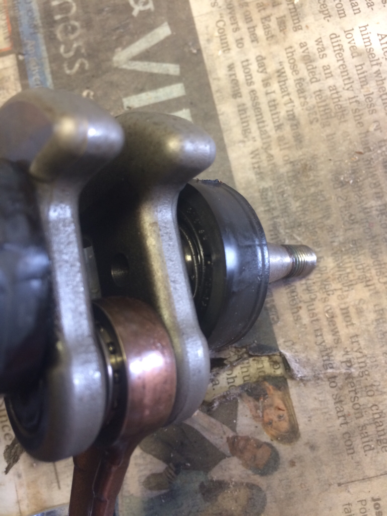

FWIW: The 335xpt uses ordinary ball bearings w/seal one side.
At least the 'boot' is good.
Edit: the rubber bearing cup has a lip seal. Bearing plus cup is $40 a side.[emoji37]
Yikes!

And oh so fun to take apart and reassemble [emoji23]
