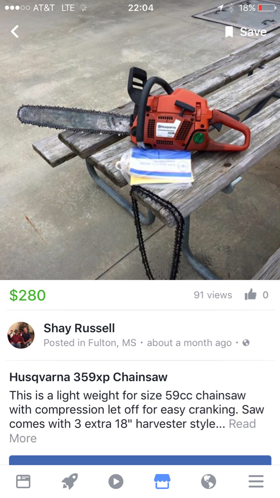

Guy in MS has listed a 359xp...

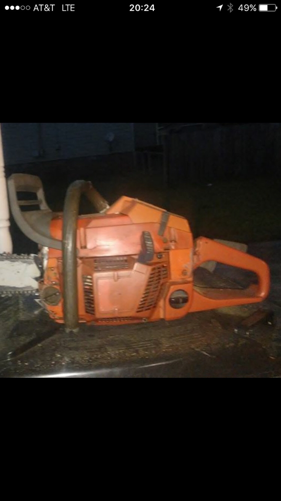

Ok..this ad just came up..says Husqvarna 266...clearly it's a 3 series..I'm thinking 362 or 365. Can you guys ID it? I'm not interested in it..if you are, the ad says $225

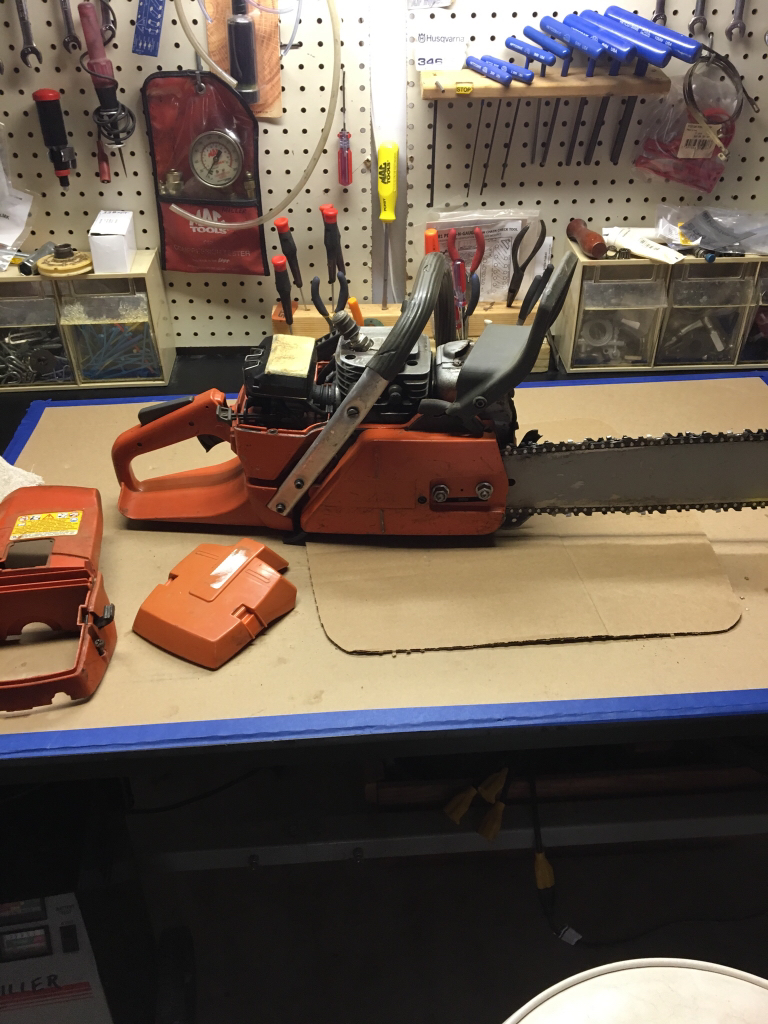

Ok...after much consideration and a very lowball offer, I bought the aforementioned saw...mostly to satisfy my staggering curiosity. It's missing the tag, all relevant stickers and has an aftermarket carb..but runs and oils well. Before I reveal (or even read) the cylinder markings (other than Mahle)..anyone want to hazard a guess? Place your bets folks...362, 365, 371, 372?
365

Cylinder is stamped 50zn21. I'm assuming (hoping) that's a 50mm bore...a 371/372? Right?
Anything in blue on the top of the cylinder? All of them say 50Z
