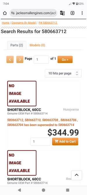

I searched and cannot find the answer, I know it has probably been discussed before…What is the difference between the 580 66 37-12 and the 580 66 37-14 crankcase on the 562XP?
Shane¹
10:16 PM
15023
Dec 21, 2020
1,756
5,332
Kentucky
Looks like -14 is the updated part number for the -12. Should be the same part
Torinocobra
7:16 PM
1226
May 1, 2016
25
47
Yamhill, OR
Okay, I see that both of them use the same bearings/seals/protector ring, I just figured that there was other changes that constituted a part number change.

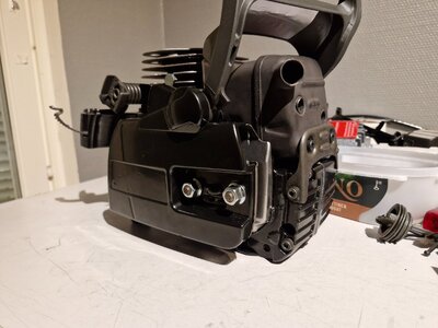

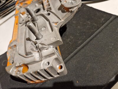

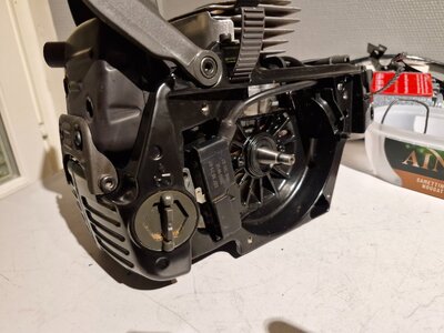

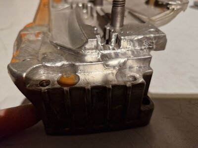

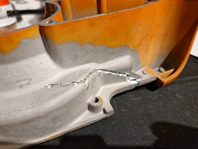

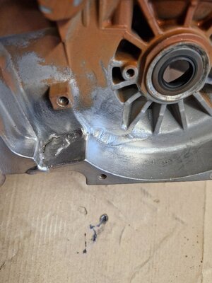

357XP crank case before and after. May not be prettiest weld but keeps oil in reservoir.

That looks really good.

Thank you, Sir.
what kind of prep do you do? cleaning agent, etc? With what my master welder neighbor has been able to do it has been a crap-shoot. Sometimes the metal is just too in impregnated with oil to get any kind of decent weld. Other times they come out like yours. It has been hit and miss over the last year. We try to clean any and all paint and oxidation away but... I use Acetone as a final rinse.
300whisper
5:16 AM
24866
Aug 28, 2022
72
321
Finland
Washed parts with hot water and dish soap to get rid of oil and grime, blasted with aluminum silicate, prepped crack with clean carbide burr, washed again with ultrasonic and finally with acetone before welding. After each welding pass brushed seams with new stainless brush. For welding I used new tungsten. Instructions per @Scarr52. Many thanks to him. This was my first attempt to weld magnesium.
