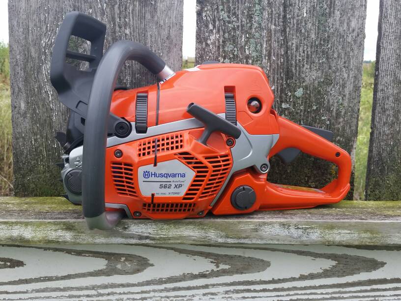

Welp....after running Stihl my whole life, I finally broke down. Got this in the mail today!
@awol ported 562
