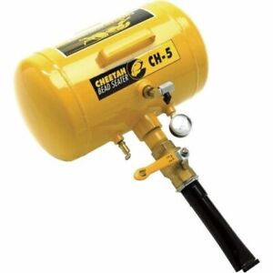

Will the crank seals even hold up to 40psi without blowing inside out?
Asking for a friend...
He may need one of these.
