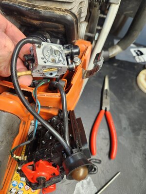

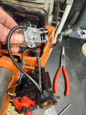

I have a 2019 572 on the bench. I was told the saw would start but not stay running.
In fact the saw will not run unless you pour a little fuel down the intake, then it will run until that is burned up.
I noticed the purge bulb will not pull fuel from the tank and upon opening the fuel cap I was just about knocked over by the stench of old rotten ethanol fuel.
I took the carb apart, the metering diaphragm was stiff as a board. I ordered a new carb kit and ran the carb in my ultrasonic for 30 minutes or so. I was then able to spray carb clean through all the passage ways.
I installed the new carb kit, set the metering height and replaced the fuel filter.
The carb acts the same as before. It will not pull fuel using the purge bulb and the saw won't run unless you pour fuel in the intake. (The purge bulbs works with both covers off of the carb.
Any Ideas guys?

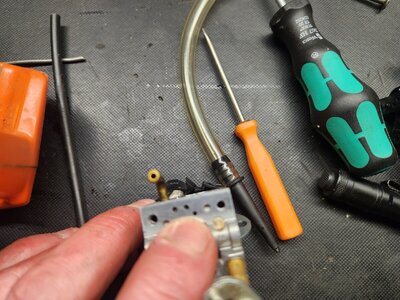

I just got done double checking and verify a few things.
The carb holds 7 psi of pressure and vacuum.
The purge bulb is hooked up and operating correctly.
The fuel line has a clean bill of health too.
I stripped the carb down and noticed if I release / unplug that small passage way the purge bulb will work fine.
I'm confident that's where my blockage is.
