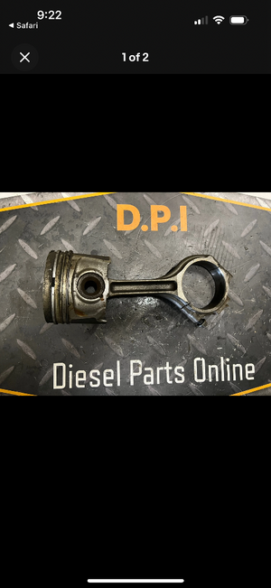

I wonder if an offset rod like in a diesel would be any benefit to torque on a short stroke saw since all that it does is give it a more efficient angle to transmit force to the crank but maybe with that angle being changed it would increase vibration.
Are you talking about the cylinder not being centered on the crank? I know of only one modern 2-stroke engine like that (Echo/Shindaiwa 30cc SRM-3020/302). It seems like a really smart idea, but apparently there are drawbacks that I'm not thinking of because it's rarely done.
Supposed to somehow transfer more torque on the crank but I’m not exactly sure how and with the cap the way it is it’s way stronger not that a saw rod would be made like this because they haven’t done a bolt together lower rod in quite awhile.

Off set bores are more common in 4 stroke, but not common anywhere. In theory they put the piston more over the down stroke and increase duration on the exhaust/transfer side. You have to make that back on the intake side but with reeds or injection that shouldn’t be a big problem.
It’s my understanding that they create a lot of vibration in a single bore engine.
I have wanted to try modifying a case and jug on a long rod saw to be offset towards the exhaust but never actually made a plan.
