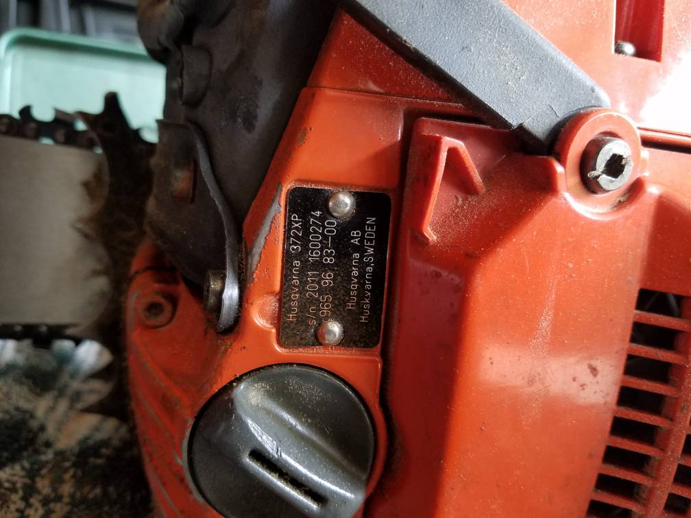

Here's my tag

Sounds good enough that you don't need to replace the coil. But your saw is about 5 weeks before they made that switch. And supposedly the newer carb can only be combined with a digital ignition system.
I'd say it's running good enough as is; and the coil option would be out there if you need it in the future.
The part number for the newest coil is 588 937 403. This one actually comes with the boot already installed, so that extra step is eliminated.
