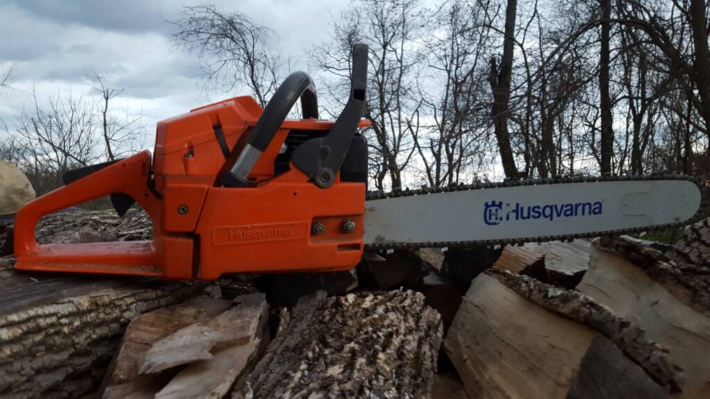

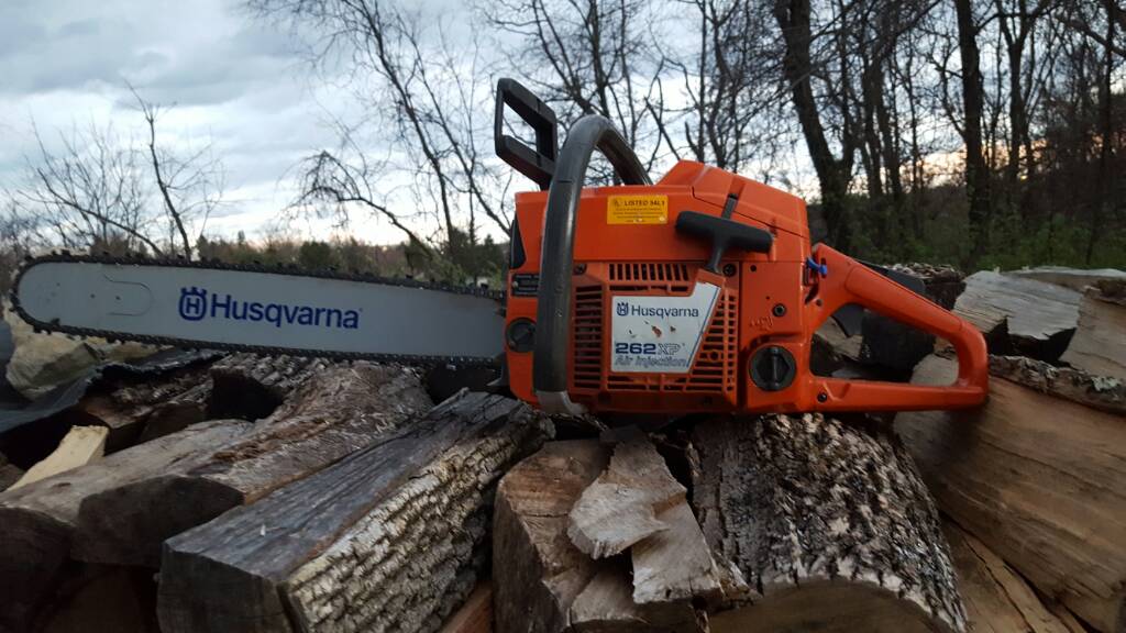

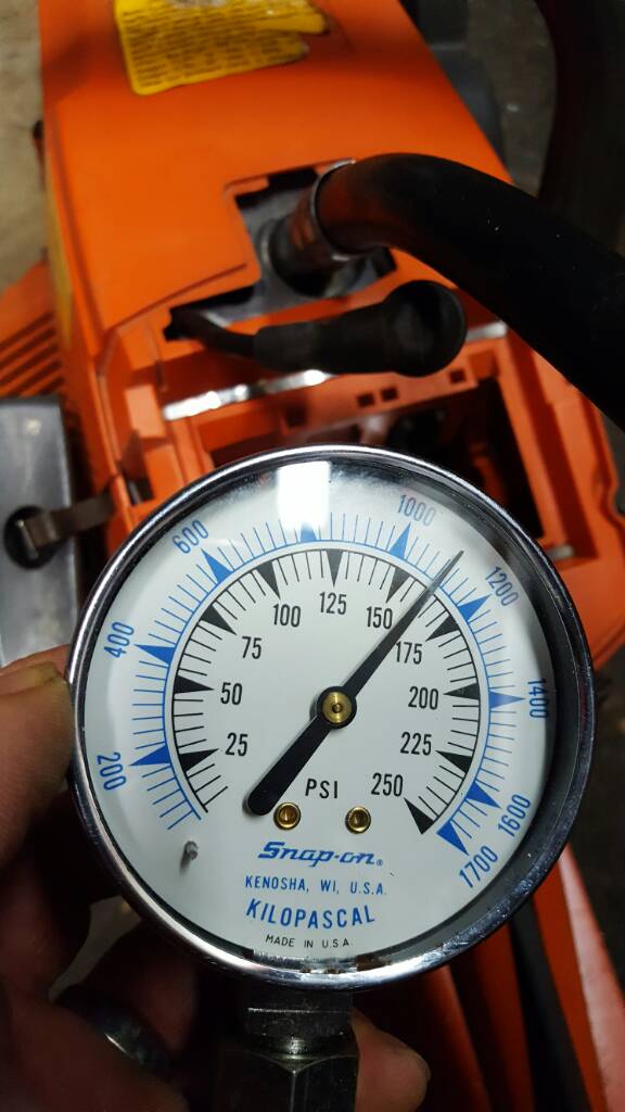

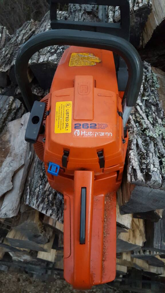

No worries guys! She's alive and sounds pretty good! Have to meet up with my carb guy...@glock37 and get my tune checked! Made a couple cuts but no good wood left and darkness came quick! Shot a couple pics right at last light! Checked compression after about 10 minutes run time. I'll check again after a couple tanks!
