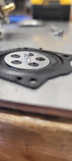

Well this is what I've found so far...the impulse line was good. The carb however is suspect but I've never seen a diaphragm actually get the edge where it meets the lever to control the float valve chipped or just worn off half way around it. Not sure if you guys will be able to zoom in and see what I'm talking about or not.

That will mess with stuff. Time to put a kit in a carb.

I finally got it fixed about 15 minutes ago. Used parts out of a 390 carb. Went ahead and did a vacuum/pressure test on it while it was down that far just to cover all my bases. Everything checked out. Slapped the carb back together with a good float setup and diaphragm and it popped right off.
