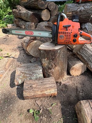

Finished this one up for the fleet, thin ring version, View attachment 459932
Beautiful saw! Mine is nowhere near that clean! I did fire mine up that the other day hadn’t started in two years. I can’t start it pho had to put a bar on it just to have enough weight to be able to drop the thing! Fired first pull!
