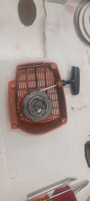

Pull the starter cover off and check and clean it , could be something simple make sure everything works properly, then start looking for parts or a full cover assembly, EBay or members here probably have what you need,

Yeah, a good cleaning goes a long way. I bought a Homelite SuperXL a few years ago from an antique store for a steal, the pull cord was just hanging out, no recoil. Got the saw home, took apart the recoil and cleaned everything really well (lots of old dirt and oil). After putting it back together, it worked perfect. I put fuel in the saw, pulled a few times and it fired right up.
If you need to replace yours (or get parts for it) then watching eBay you can see them pop up there from time to time. Once you get enough messages in here in the forums, then you can post a "wanted" request to see if anyone has one (or parts for one) for sale.

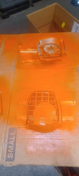

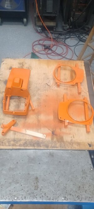

Would love to know how you refinished them, try look awesome. Would like to Re & Re my saw. Get the paint at any husky dealer?
Got the paint online. The cheapest was by the case, 6 we don't really have a husky dealer around here so I scrounge parts on ebay, here or other online sources.

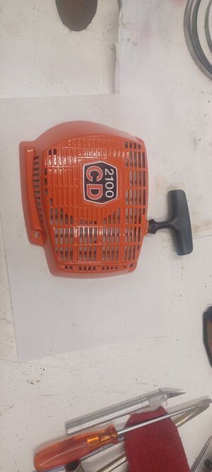

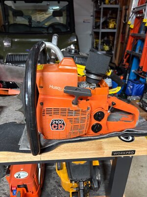

Ebay. The one pictured came from there. I just restored it. Shipped, around $40. It was complete so replaced only the rope and pull handle.
Make sure yours has the correct recoil and air shroud. Sometimes Guys slap a 480 recoil on or with the wrong air deflector or wrong pulley, etc.
Prices on a complete 2100 are all over the place but most out there are missing something or are Frankinsaws.

It has to be the 3 dog aluminum pulley . the 298, $ 285 had the 2 dog style and wont work on yours
