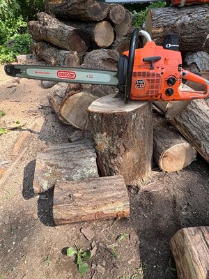

The two I have also have different mufflers, this one have the outlet in the lower front through the louvers. My other one has the outlet on the clutch side up top. I read there is a “jungle” type muffler and maybe cylinder?

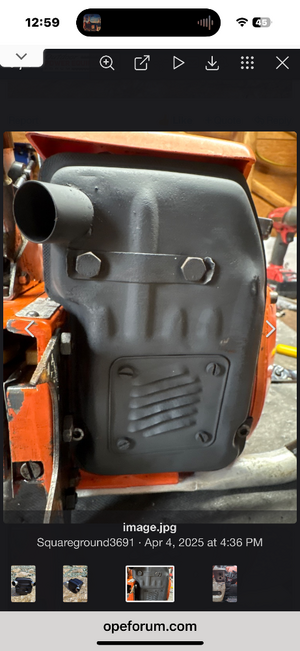

Need to duel port those mufflers, and cut baffle out , the big girls like to breathe, IMG_0476.png
