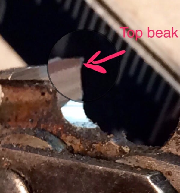

I did this one tooth. Does it look like it could work if I play with it some?
That'll cut, but your file was a tiny bit low. And your file should probably point downhill a bit more. It'll cut like crazy like that, but won't last as long

I left it at 40°. I may try 50 which is max. the other 2 I put on 20 to get the angle closer. I'll try and move the head base a few more ° to get the angle steeper. I'll play around with it some more before I leave and see what happens.
