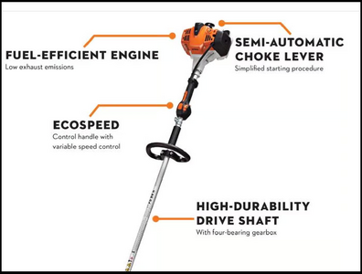

I wonder if there is a way to put the cruise control dial on it like some of the bigger ones have.
If you don't have the 91 with the bike handles, take a look at the FS 94 handle, it has a variable throttle. I never really understood the need for it on this trimmer, but if as in your application you want to keep it steady at less than WOT, then it might work for you. All this handle does is retard the trigger at certain levels so you can hold the trigger and keep it at the level you set. It might be a direct swap which would be a win/win for you.
The throttle cables are different (the 91 has a butterfly carb, the 94 a rotary) but you may be able to swap cables or put a different end on it. Or buy a smaller 2 stroke trimmer. A sharp blade doesn’t need torque.
It looks the same on the outside!! 🤣
Good to know about the cable types, but I suppose if he was determined he might be able to find a work around.
