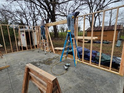

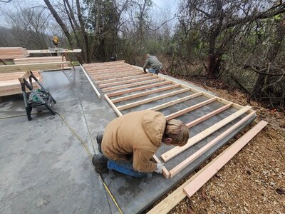

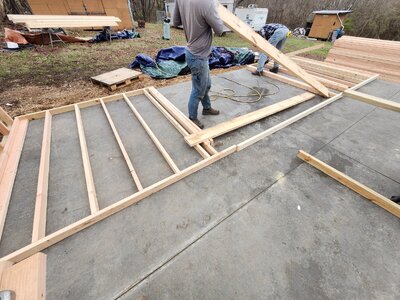

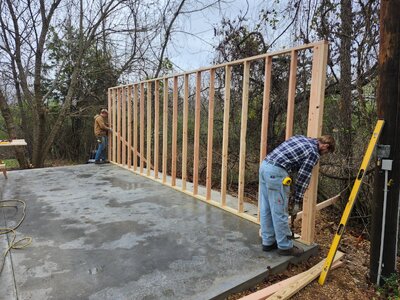

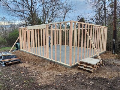

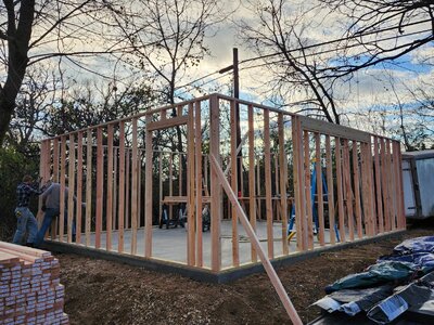

Do you drill and use concrete anchor bolts for attaching the walls? When I added onto my house I went a little crazy on how I did things. I laid out all my floor joist locations first, placed my anchor bolts and tied them into the rebar in the foundation wall. I bent my vertical rebar into boxes on the bottom to support four pieces or rebar that run though the footing. So the footing is tied to the sill plate basically with an almost direct connection. Things aren't moving here. Maybe I thought things out a bit too much.

Yes, we decided to use wedge anchors on this one...wet set anchors are a pain.
If you get hit by a serious storm, it'll have to make matchsticks before it comes loose from the foundation.
