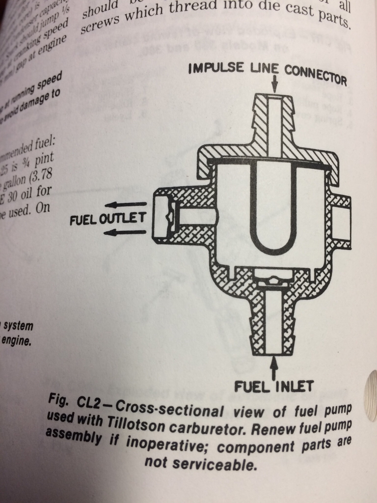

Clinton uses Tilly HC. A separate fuel pump between tank and carb.
Got it to run for several minutes.[emoji106]
The metering diaphragm is stiff so I left the fuel shut off, primed it by bottle and zip tied the trigger. When it began to run I opened the fuel petcock. Found a sweet spot where the throttle was open far enuff but not flood completely out.

Getting a carb plus the 'fuel pump' from the Valley Falls evilbay seller.
Figure a pump would be a smart spare to have.
