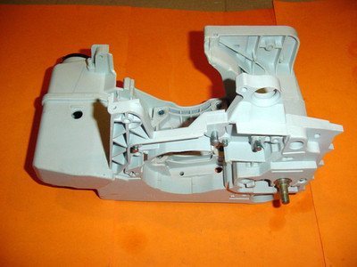

You say it’s cracked, but how bad is the crack?
It’s plastic, maybe just patch it?
How bad does oil hinder plastic welding on something like that. Thinking of threads that dealt with welding crank halves where they were degreased and baked and then degreased again to clean enough to weld.

So last couple of weeks noticed just a bit of bar oil under my saw. Last week we kept saws in the back of the truck and noticed but wasn’t a whole lot and there was still oil in the tank. Closer looking and there is a crack just under the cap for the oil. It is on a MS390 and a new tank is $127 from race bros. Has anyone changed one of these out? Looks like almost a whole year down to replace.
Ms290 and Ms390 are basically the same saw. 390 is just a bigger bore, same stroke.
Everything else will interchange. You can take a 290, slap a 390 cylinder and piston on it and you’ve now got a 390. I had a 390 once, was an excellent saw. Sold it to buy parts for a truck I had. Wouldn’t mind having another one.

I will probably try the epoxy/glue route. Not sure how far the crack goes down along the bottom part of the handle. The oil tank doesn’t completely empty out.
I don't know much about it, but there are some plastics that benefit from hitting the surface with a torch flame to remove the gloss. It has an affect on roughening the surface to accept paint or adhesives. You could probably find more info using Google our youtube.
