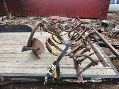

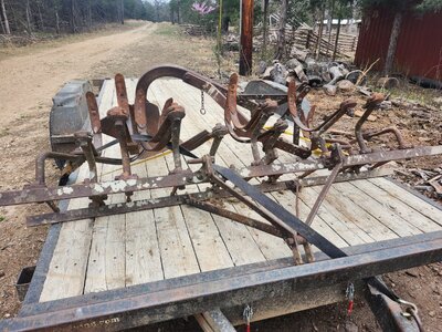

Anybody know stuff about welding spring steel?
@moparnut88
Got a one of these with a few broken tines.....
View attachment 463737View attachment 463738
i consider myself pretty decent welder but i havent had much luck welding that before. i would suggest to replace the broken ones. if you wanted to try preheat whole tine to 350-400 then weld it with 7018 and then post heat back to the 350-400 cooling down 50* every 30 mins until ambient temp. if you do that and it doesn't crack at the weld it should hold. also while cooling if you peen it where welding it should help it keep from cracking. or if you have a ton of dry silica sand heat it up post weld and bury it to allow it to slowly cool.

Is Tom contemplating plowing something down there?
You got a spot with some decent topsoil?
Sam's been "plowing" the universe down here, hence the busted tines.....poor kid, thinks he's a farmer.
Pretty much less that zero actual dirt here.... just flint, limestone, and goopy red clay.
Thanks buddy!
Way too technical for a 16yr old hillbilly.... guess I'll see if I can find him some replacement tines, lol.
