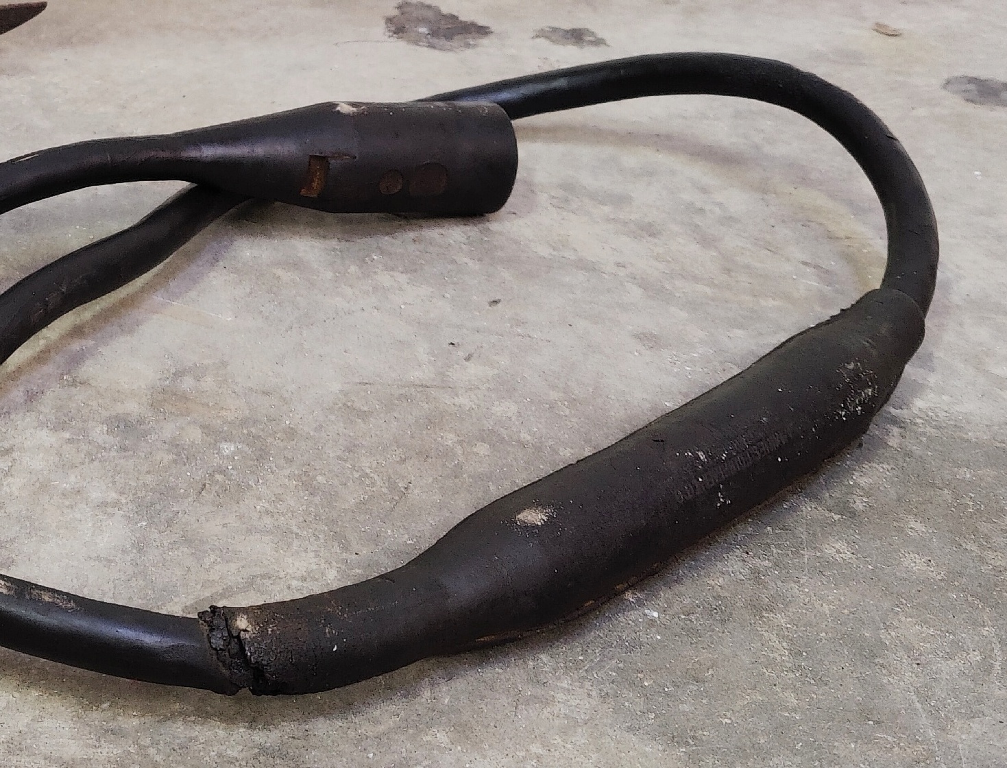

Good morning!
Circuit check on the Homelite ECS came up with good field coils in the motor. Found an open in the phase 2 wire in the cable inside of the enlarged splice section.
