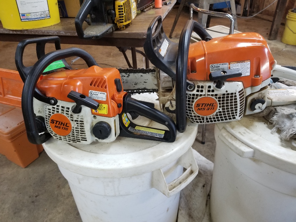

Good afternoon y'all. Working on a ms171. Little saw has compression, spark and seems to be getting fuel. What a little turd!
Gut muffler, change carb to fully adjustable, add a little cheap time to it , it helps a bunch , check seals , they are bad to leak on that model
Here's one a did a few weeks ago, it's much better, i put new motor in it for 42 bucks Amazon LOL
