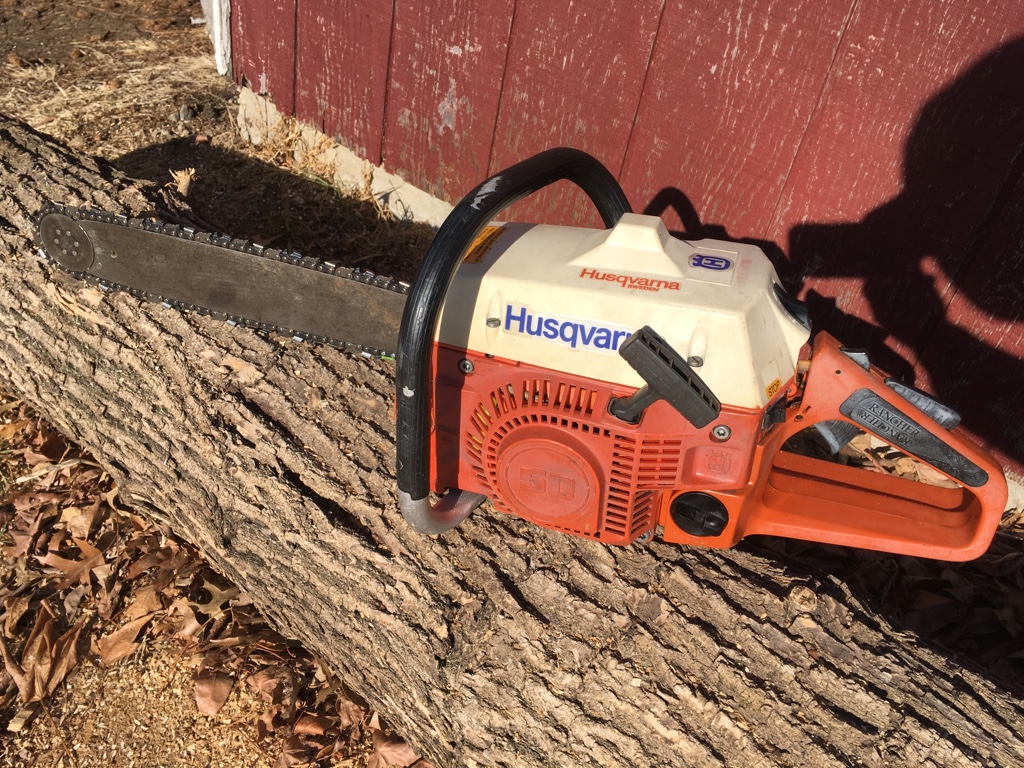

Works better now.
Still waiting on the starter spring. [emoji853]
