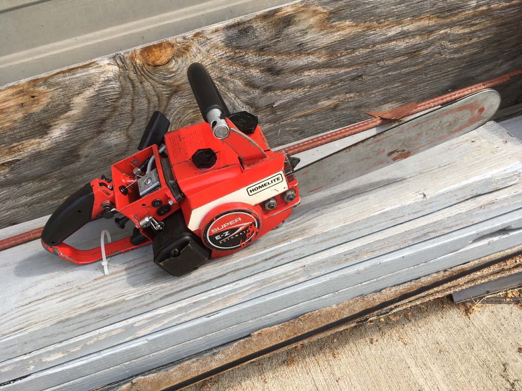

Getting the SEZ sorted out.
Carb was all messed up. Metering lever set way, way high. Gasket & diaphragm in wrong order. It puked fuel when trying to pull start. Springs lost off the mix screws. [emoji849]
Piston & cylinder look pristine from the exhaust port. [emoji106]

High side not passing fuel now. [emoji849] Was puking gas out. Now runs at an idle but dies whenever you open the throttle, no matter where you spin the needle. [emoji37]
At least I don’t have to pull the flywheel.
Anyone got a good HDC for a Homie?
Little bigger pumps 140 cause I checked.[emoji56]
Whats the carb number
