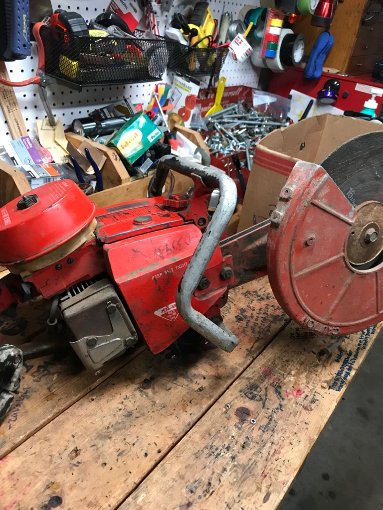

New to me XL-98. Anyone know any info on this thing?

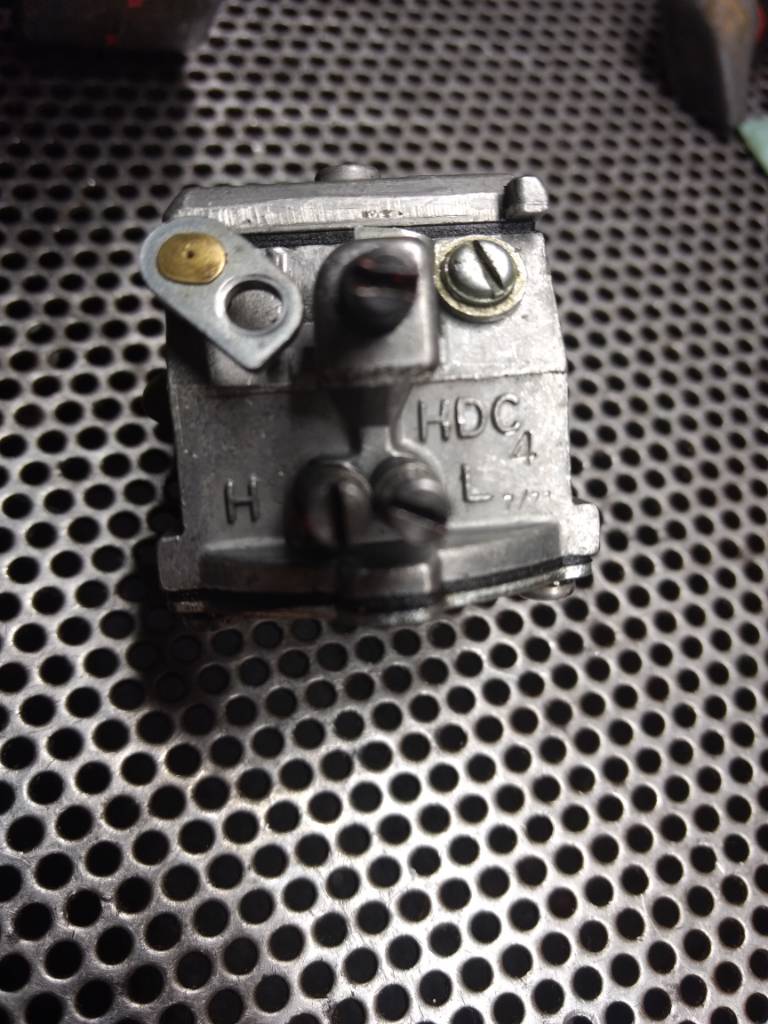

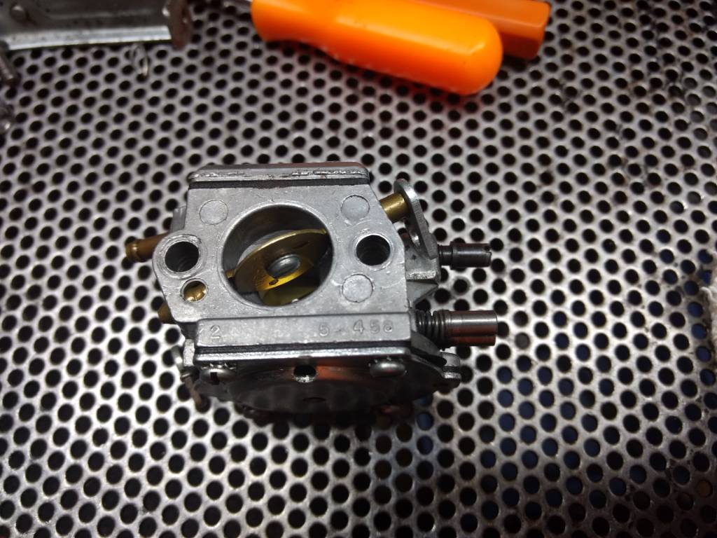

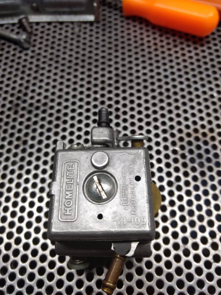

Ok I got some pics of the carb...
HDC 4. Looks like 7/73 (production date?)
2 21-109
Then on the intake side 2 5-458
@chainsawlady
