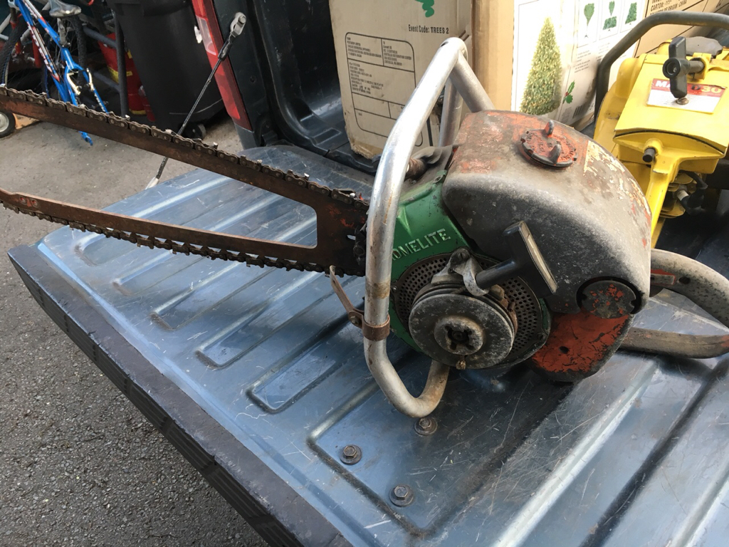

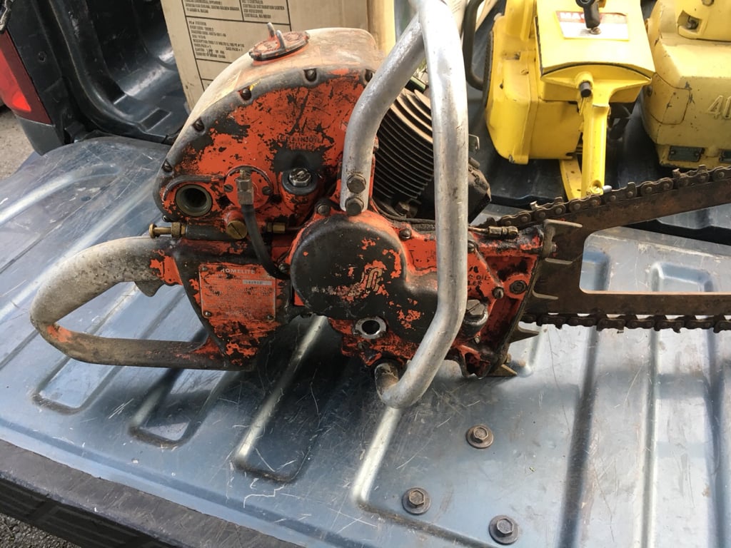

Just picked up a haul of homelites , a model 17 l-a, three 330,s and an xl -12. Pictures to follow. If anyone needs 330 parts I am not going to mess with them. One he said is a runner and the other two can be put together to make one.

Ahhh same old story, keeping busy with other people's stuff. Took the muffler off to look inside and piston/cyl look great and compression test was very good. Cleaned up the muffler and prepped it for some paint and far as I have got. I spent more time on the XL12, but may let it sit the shelf as you mentioned. It's piston/cyl is not bad compared to others that have messed with. One of bolts had backed out from case half behind clutch and was broke off. Part of clutch was busted and gone too. I have a pile of homelite carcasses so just be deciding what I want to do.
