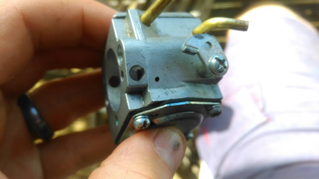

So I tore down the oem HD-12 carb yesterday, pulled all the choke and throttle links, flaps, shafts etc, cleaned and reassembled.
After a cowboy pressure test with blue tack around the choke and throttle shaft ends, and a hand over the bore and blowing through the other end, I found that there was an air leak through the tiny hole that the return spring of the choke shaft sits in on the outside of the casting. Pretty perplexed as how or why air is coming out but a little JK weld and a redrill this morning and the carb is back to fully functioning... o how I forgot how much I like this saw..

? I need a picture but really interested in what you are saying

So I mean the tiny little hole to the right of the choke shaft hole. It leaks a lot of air. Or draws in alot of air. What ever was happening is all now OK!!
