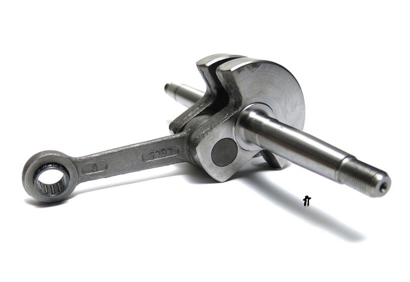

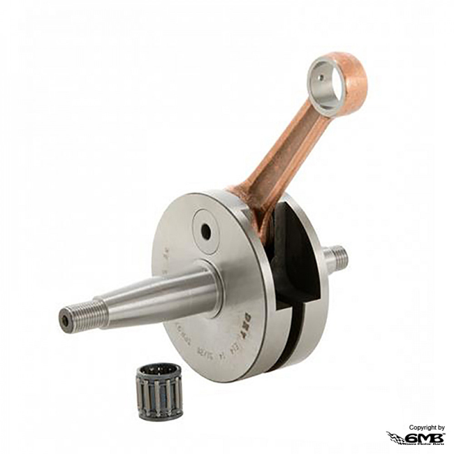

What is a 'full-circle' crank?? Sorry, this has no meaning in the UK.
MSaw
Active OPE Member
1:13 PM
5736
Mar 28, 2018
11
2
Scotland
Is there a perceived benefit? They are just designed for different saws? Both will be dynamically balanced and well it's a toss-up on other matters. The top flywheel will give a more even chart on torque over a cycle and will run smoother whereas the more traditional crank probably has less overall rotating mass. Interesting, thanks.

It has more to do with case volume than balance. Therefore affecting throttle response and torque.

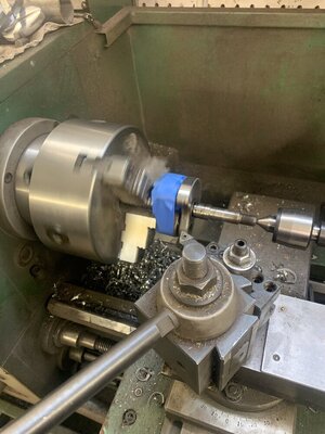

What are you using for the outer band?
FWIW, the stuffers from a k970 crank look like they could fit 395 with a little work.
i had wondered about the stuffers from bigger saws.
its fairly gangster, i think it was a 2 1/2” pipe coupler that had the perfect OD, i turned the inside diameter out a bit then turned down crank weights until the ring was a snug fit. plan is to tack it in place and fill w epoxy. i like the idea of the factory stuffers tho…
