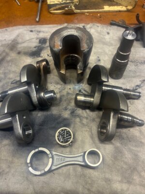

Ok here we go

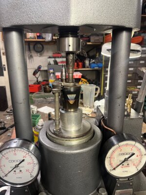

The new 361 crank (£25+£4p&p) turned up today but with the 10mm con rod
I’ve pressed apart both cranks a swapped the con rod
I’ll add a few pic here

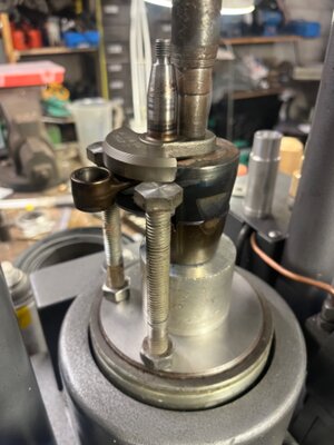

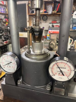

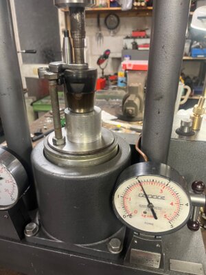

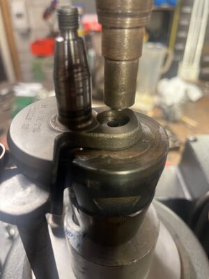

These pic are of separating the new 361, the 362 took 5 ton pressure to get it moving and 2 ton there after, the new 361 took 2 ton.. I’ve pressed other cranks at 10 ton these 2 where easy..
But it helps if you have the dogs bollock 5 our 30 ton press with tonnage gauges newly acquired £300.
I’ll add a few more pic here

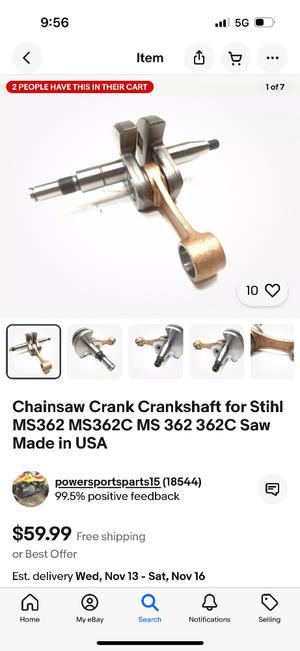

This pic is with the new crank and old con rod not yet pressed together.
Oh and that pot at the back was a 40int arbour modified.
