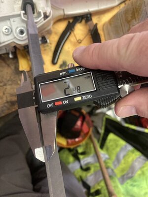

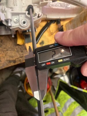

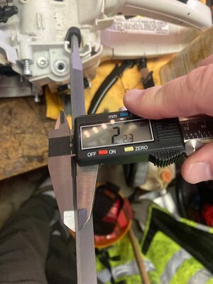

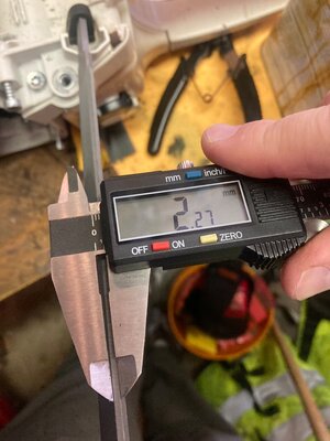

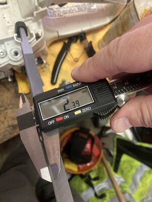

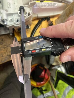

. Never occurred to me they could be different dimensions. When I switched files to touch up a chain it did take a lot more work than it should have.

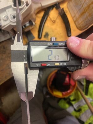

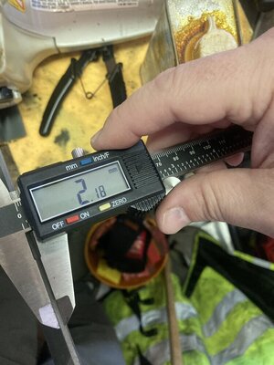

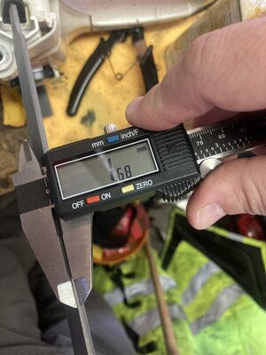

The old mantra is true, for the most part, you get what you pay for - and Vallorbe, Pferd, Bacho, etc have much better quality control/consistency in their manufacturing process…
Some measurements of the Forester file’s side cutting bevels - lots of variation in the two different ones I measured. As a comparison, I also measured a Vallorbe 2279 that I had on the bench - all of those side bevels were the exact same width…
First Forester file -
