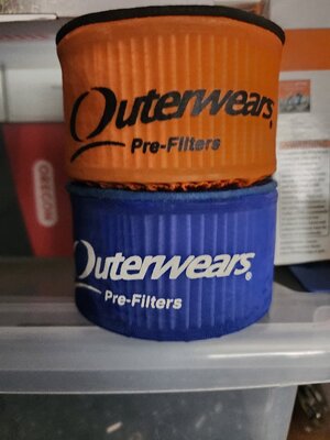

Stock paper filter with an Outerwears cover is a nice combination that stays clean while working and lasts a long, long time. While the foam does catch everything exceptionally well, it also gets harder and harder to clean the trapped fines out from inside. So, it comes down to what your usage/maintenance regimen is like to what is suited best for each user.
Do you know the ow part # that fits the 462 filter?

Thanks fellers, got one for my 462 and 261, free shipping at time of order if anyone is thinking about buying.
