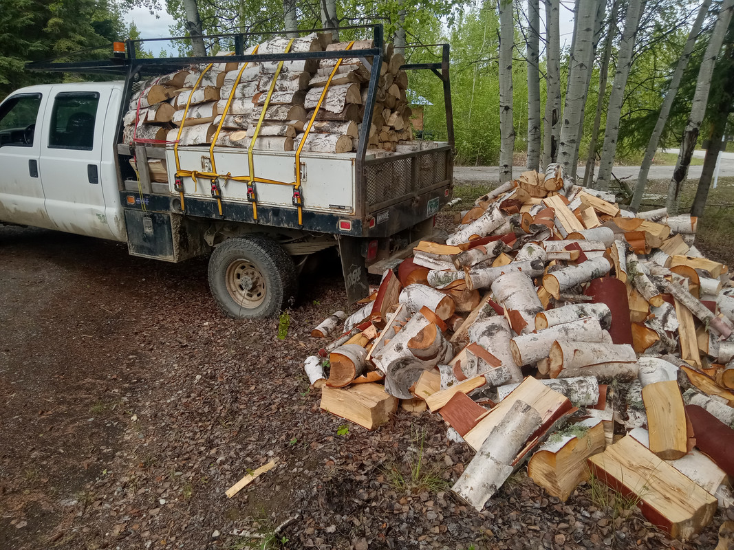

If you're doing top soil or gravel hauls combined with firewood deliveries, a dump bed is pretty handy.
BUT, if your just doing firewood deliveries, though a dump bed is handy, you don't need one right off.
I delivered 4 cords of split birch end of May with only a hookaroon. I run a small tree service and firewood business as a side-gig to supplement my boat building. I find that as my jobs get bigger, I'm having to be careful and slow with my spending so that the money for completed jobs is more profit, rather than loosing the majority of my profits into big equipment purchases.
Using a hookaroon to pick n chuck, its really fast to unload an entire cord. It took less than 10 minutes to chuck an entire cord. Total time: a half hour to pick n chuck the entire 4-cord delivery. Not really a big deal compared to the cost of a dump bed. Just something to think about.....
