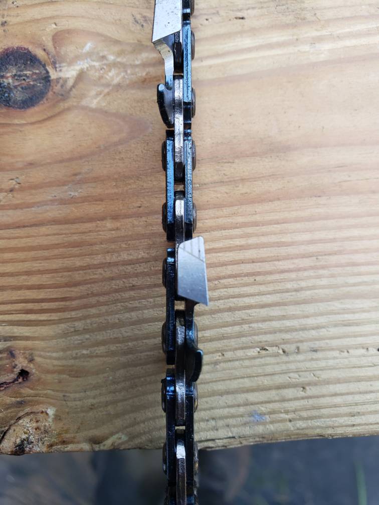

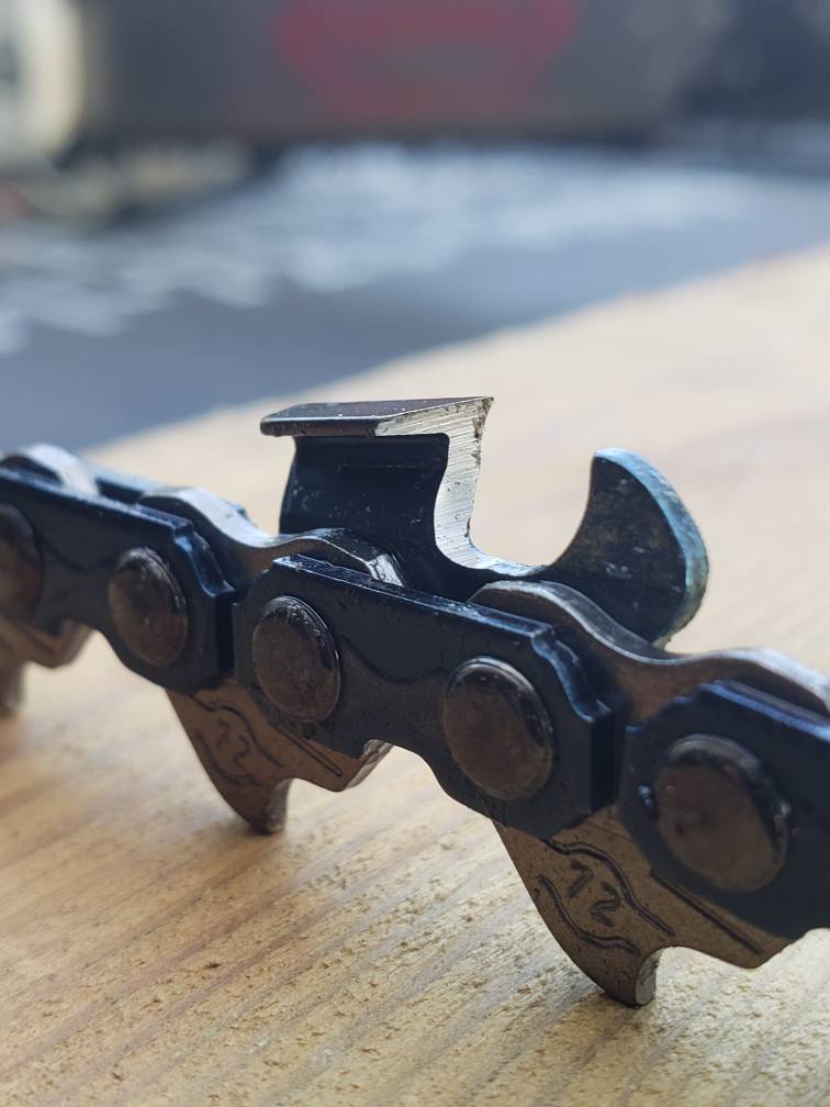

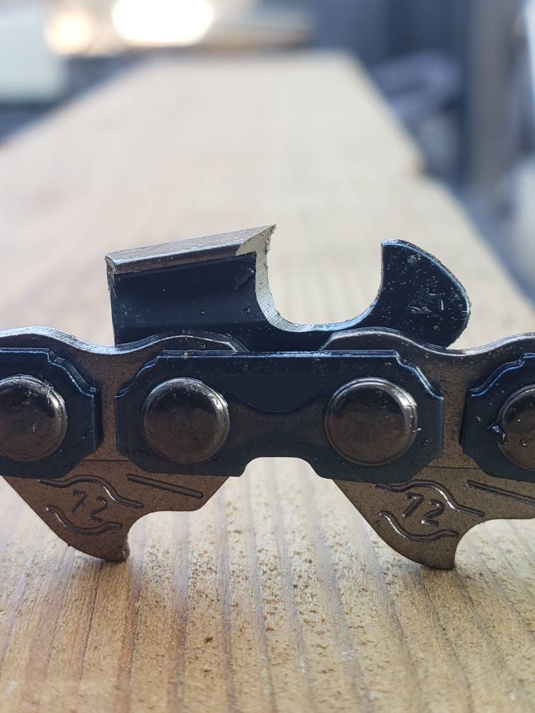

Here you go Wilhelm.
3/8 Oregon EXL chain

I know, yet 3/8" Full House doesn't seem to be easily available.
Looking good, but I want as many teeth as drive links. :D
I think it has been tested before, Semi skip chain is faster than full comp. Clears chips better.
