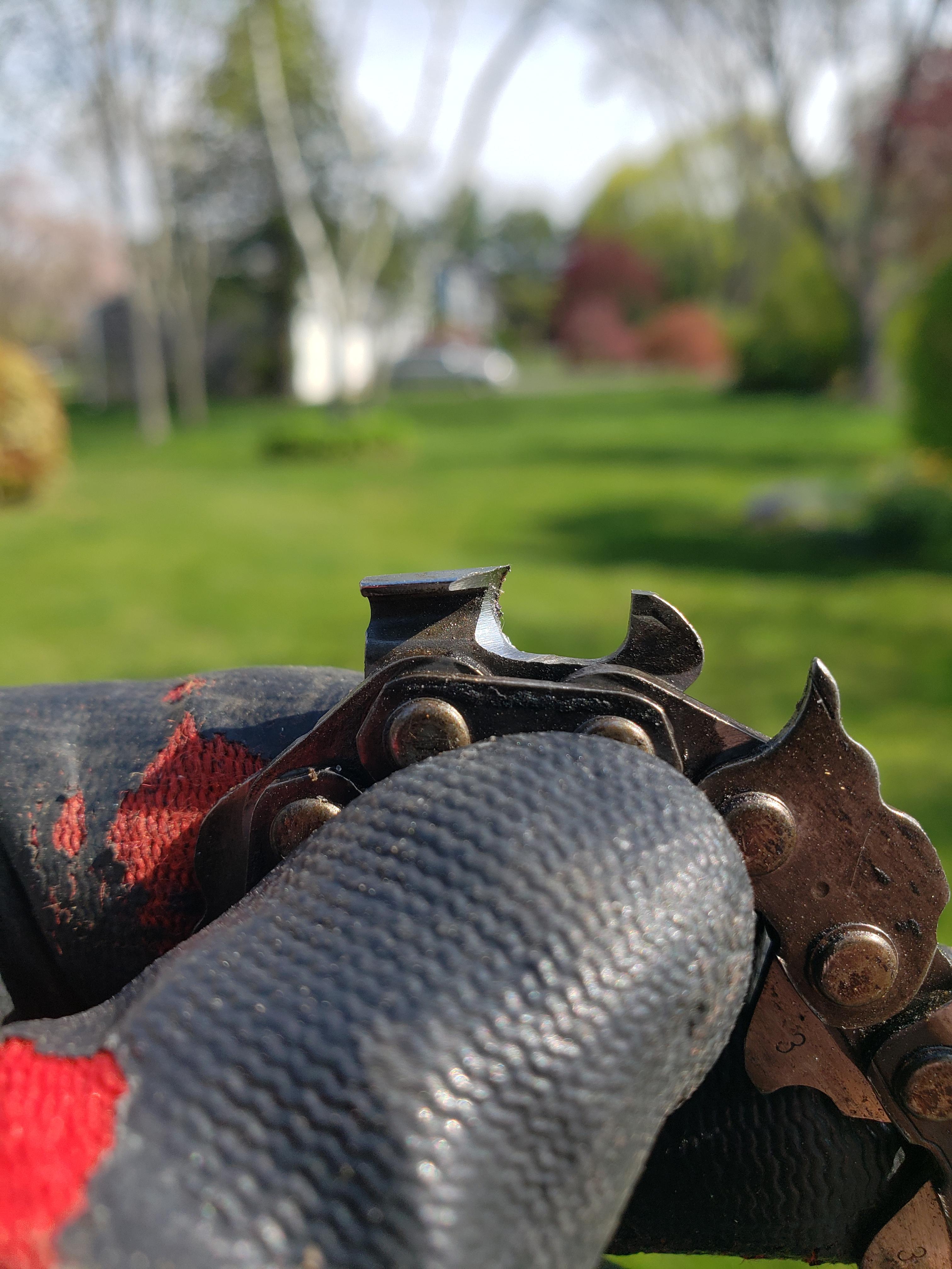

I have never seen anyone file semi chisel square before. Lol
I am anxious to hear how it cuts.

One of my 3/8 semi chisel cutters. Not the best, but good enough for who it's for.
