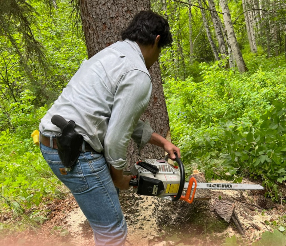

Got another milling gig for an older fella. Dropped 5 large white spruce saw logs with the cs 8000. Also used to limb and cut to 18 ft logs. So 10 saw logs total. Firing up the cs 1201 milling saw later today.
Had to bore cut one heavy leaner. 28" bar wasn't big enough for a clean bore cut, so nipped off some of the root base on both sides of bore cut. Compared to my 620pw, my jonsered 2172 and my echo cs 6700's, it's different than most 60-70 cc fodder. You definitely can tell you're falling trees with 81 cc of ported torque. The saw isn't "peaky". It hits a big flat plateau of power that starts lower in the rpm range and carries that power above 10,000 rpms in the cut. It's much smoother than my old ms 660 magnum.
The big fuel tank, could go two trees at a time, felling, limbing and bucking, with lots of idling. As the tree thinned near the crown, I'd just go grab a 50 cc saw, so cant really complain about the weight. I honestly think that a 32" light bar might be better for dropping saw logs. The oiler is filthy-good. Bar stays cool to the touch in hot weather. No chain stretch. Chip clearance is excellent in the big, cavernous clutch cover. Where my jonsered 2172(re-badged 372 x-torq) would plug up with noodles, halving the stumps, this 81 cc saw doesn't plug up.

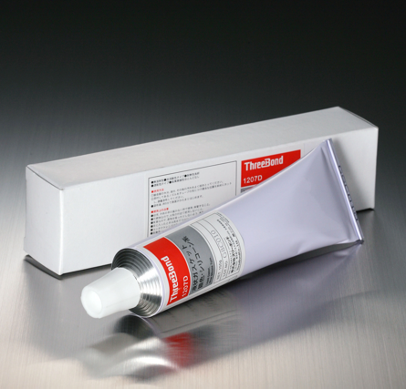

If you decide not to use a base gasket Tom. Do yourself a favor and get some Dirko. In my opinion, there is nothing better.
Woah, this is threebond1207d territory round here. Part# ECHO X686000000. Good to 40 below zero.
Echo has a marketing issue.
I would've called it threesome1207double-d.
Stihl would've just called it "magnum-bond"
