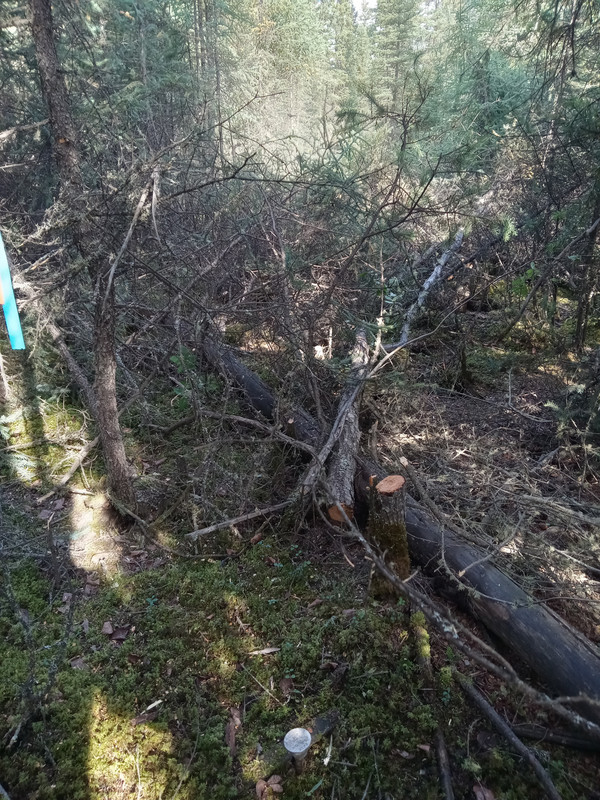

Eating my words today, about not really "needing" a 50 cc saw. Started another clear-cutting job, one acre clear-cut. Its so thick with scrub spruce, I can't even see 6 ft in front of me.
I have never cut for so long, and seen such little progress to show for it. Even with a 20 inch aluminum core bar, the CS 620pw is too much weight. 5 hours of cutting, was so sore, slept for 12 hrs. Obviously have to switch to something lighter, and maybe get a full 8 hrs of cutting.

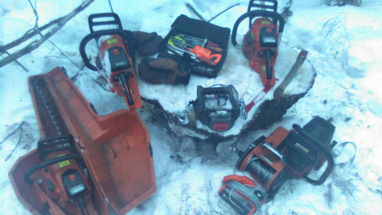

Tuned them at an early winter cutsite back in 2021. right before sending them off. .015 off flywheel key. Gutted muffler, retuned carbs. They pulled hard with that stihl full-chisel 3/8 low profile. Both needed new primer bulbs and spur sprockets. New bars as well:
