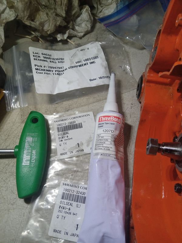

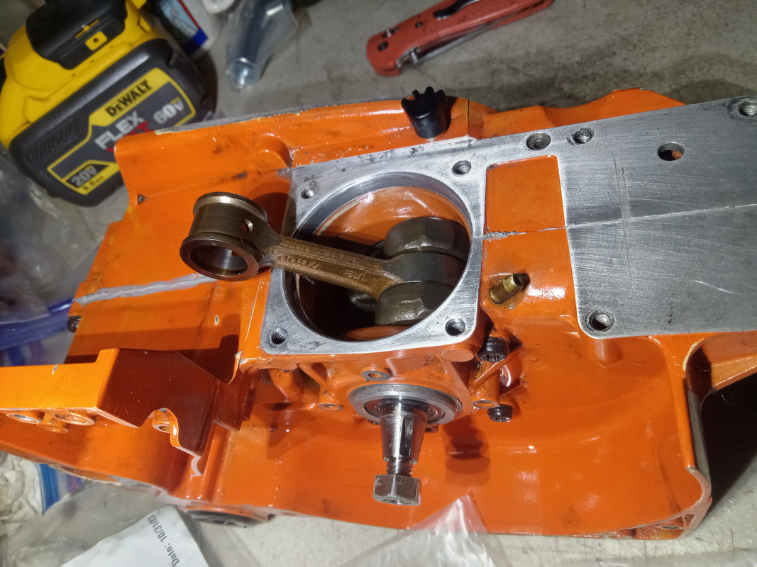

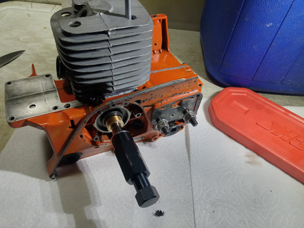

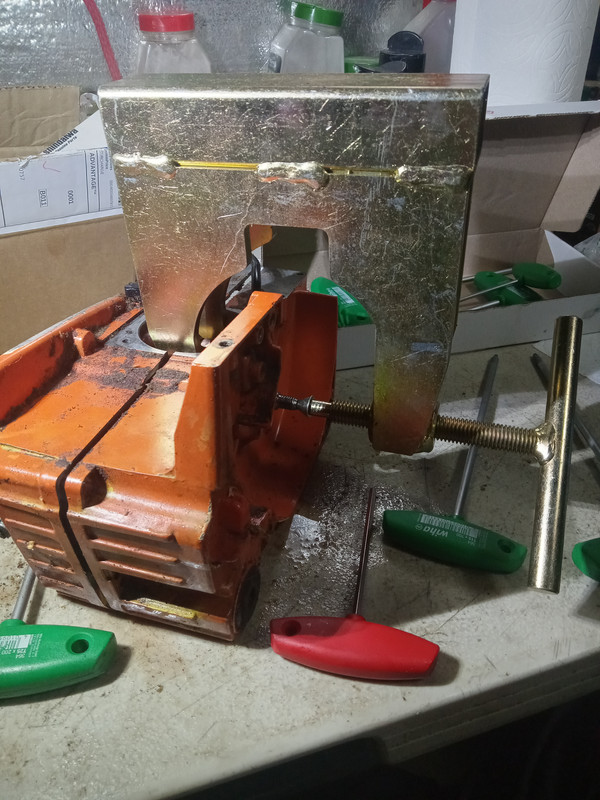

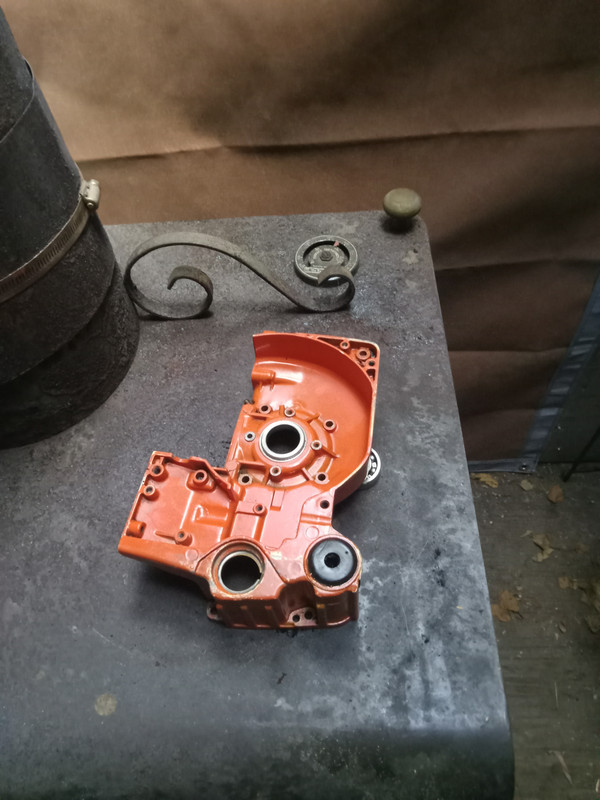

The old flame-torched qv-6700 got new bearings, seals and case halves sealed up with threebond 1207d. The old sealant was washed away and thats where the airleak came from. I'm sure sealants have come a long way since the saw was assembled in the early 90's. Bearings and seals were fine, but replaced them anyways. Will rebuild the carb tomorrow.
Case halves split easy. Cleaned them and heated them up on woodstove to expand the bearing pockets. Put bearings outside in the cold to contract them. Bearings dropped right in. Once assembled, the bearings had some tension on them and the crank wouldn't spin freely. Couple taps on the crank ends, and everything is centered, crank spins freely. Very easy saw to tear down.
Needed an echo-specific puller for the press-fit oiler worm gear and another echo tool to reinstall the worm gear. I didn't mind purchasing the tools because these metal oiler gears are worth it. They never fail like the plastic worm gears.

Bummer, cylinder didn't clean up, scored through the chrome plating. Hopefully I can find a good used cylinder. If anybody knows of a used 6700 cylinder, would be greatly appreciated.

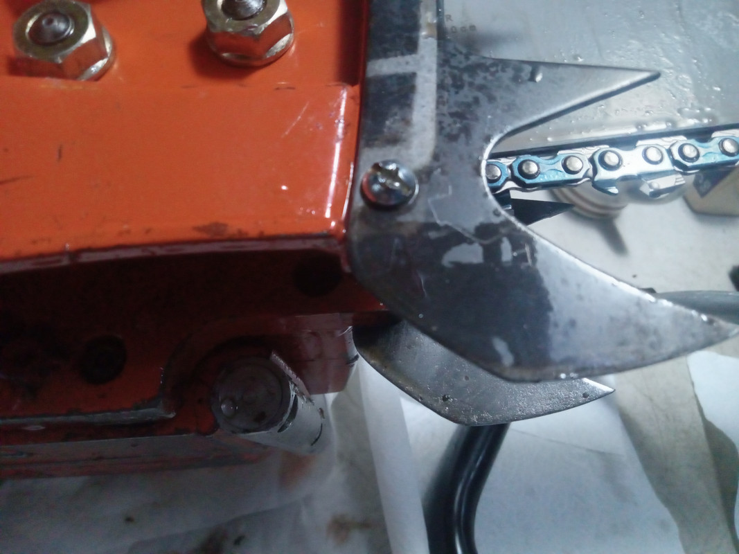

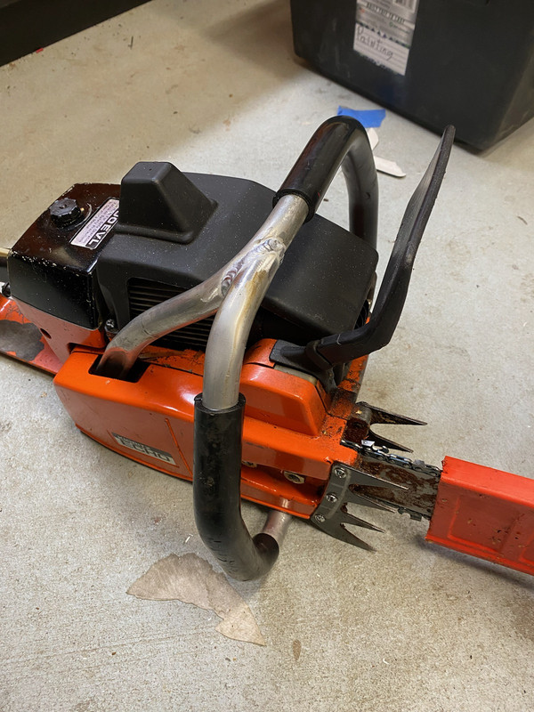

Have a spare cs 900 evl handle, so trying to figure out where to cut it down and tig weld to existing handle to make a full wrap. The bottom of the saw, handle-end is completely exposed. This will be an easy job:

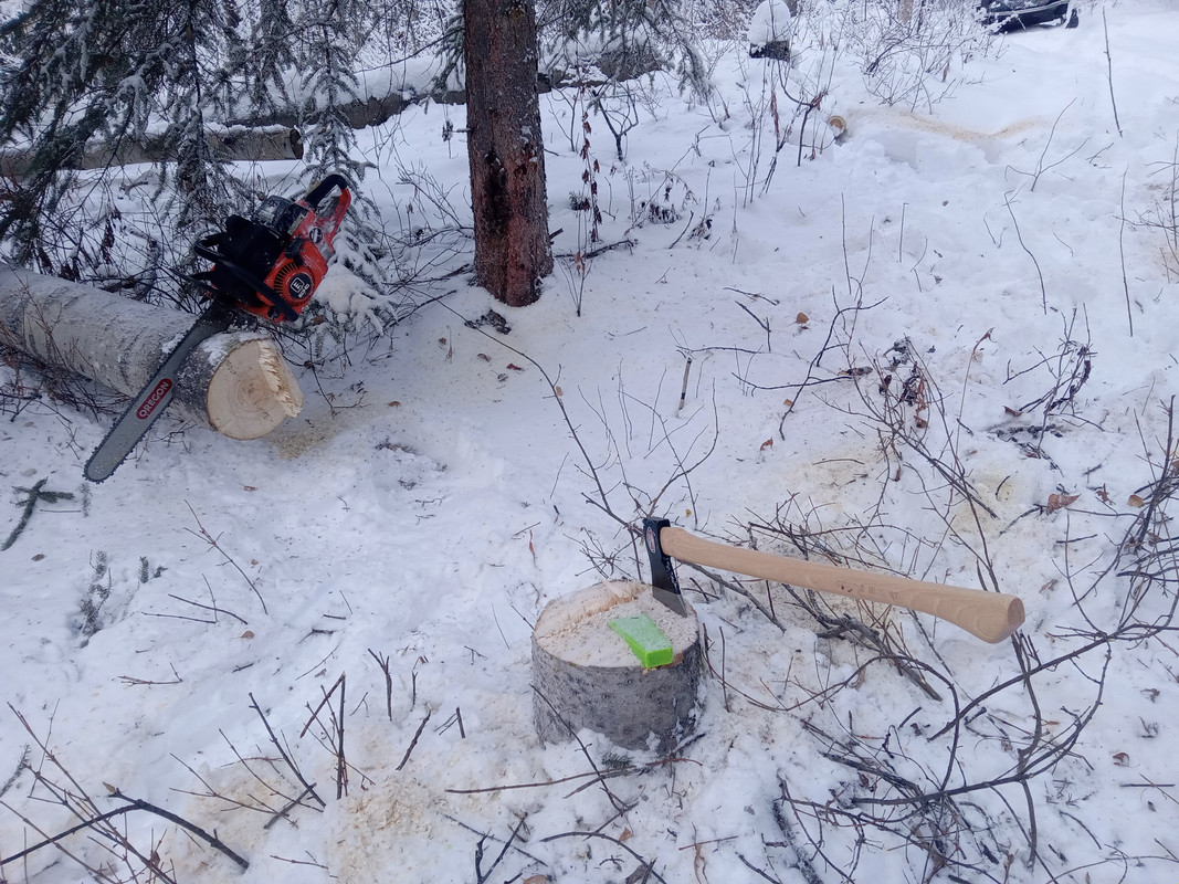

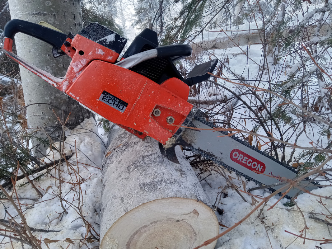

Finally enough snow to clear my 3 mile and 5 mile dog mushing trails. Widened a couple turnarounds, cleared blowdowns and cleared a few trees that make for dangerously tight turns.
Enjoyed working with the cs 900 evl. Way ahead of its time. Its a modern saw, but simple.

The 6700 is getting close: new cylinder torqued down onto a hearty bead of threebond sealant. Without base gasket, squish is right a .040". The finish/qaulity of the ports was so darn nice, I'm not gonna grind on a single one of em. The ignition advance, muffler mod and base gasket delete will be plenty.
The original worm gear was a plastic one. I upgraded to the brass oiler gear used on the cs 670, using the echo oiler gear tool.

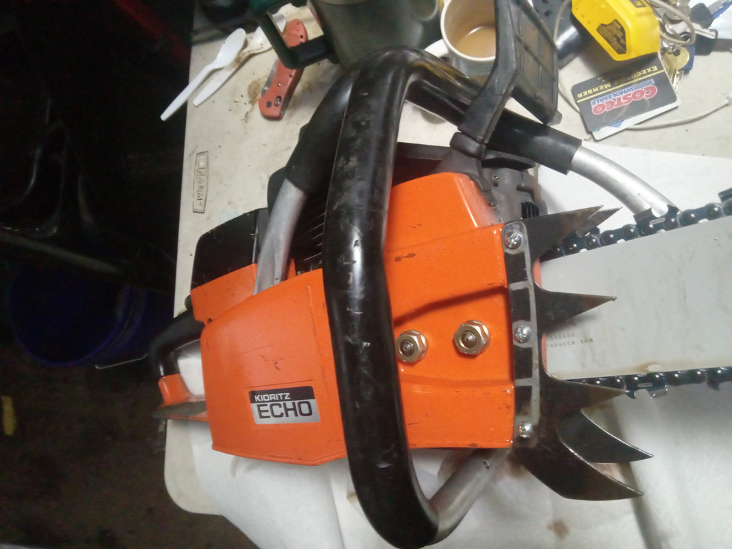

Howdy I'm new to this thread but I'm enjoying the content. I just bought a 650evl at a pawn shop. It was marked as a non runner as-is. I figured it was worth $50 for the cool factor. As with many pawn shop as-is "non runners", it runs.lol At least, it starts. I'll look through it before I try to cut with it. Quite undeliberately, I'm amassing a very small vintage saw collection. Olympyk 999f. Stihl 056, 041, and now the old Echo. I have a few old Homelites as well but they're a dime-a-dozen around here so not very exciting.
I've been intrigued by the Shindaiwa/ Echo affiliation mentioned here. I have a 22t Shindaiwa weedeater that is nearly 20 years old and has been a joy to own. I'll be watching for some of the pre-merger saws mentioned here.
