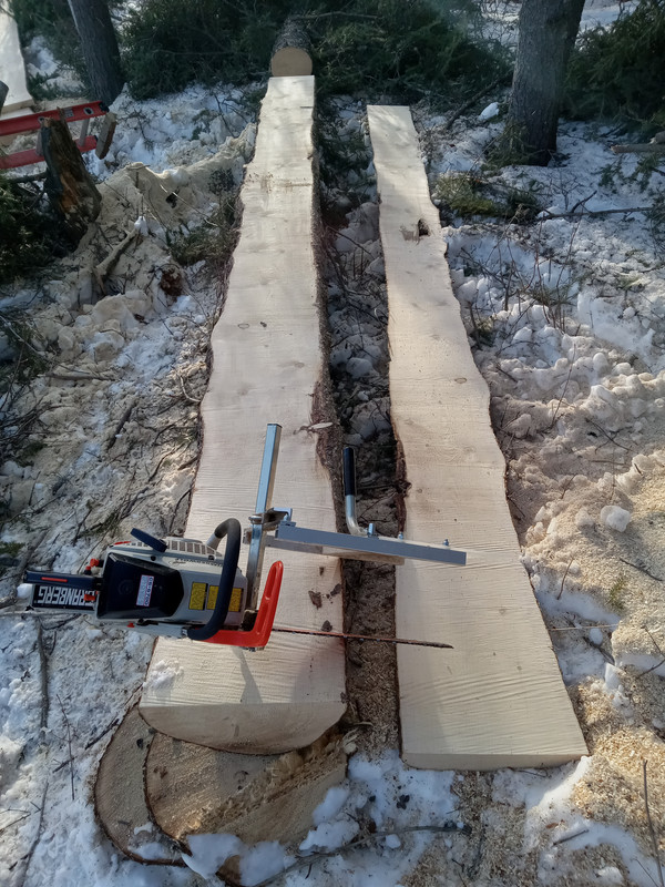

Hello Echo chainsaw folks. Hope all is well with everyone. Dog mushing season is slowing down, so back to milling and moving slabs before the snowpack goes soft. Paveen-ported cs 1201 and ported cs 6700 are running great.

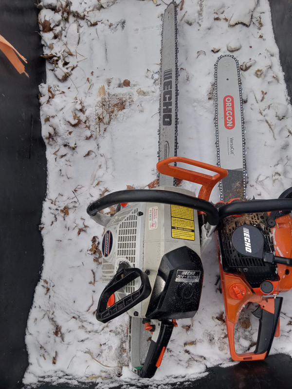

Just finished that ported qv-8000. The build drug on and on and on. I don't envy any of you saw builders. Needed more parts than expected, and took forever to clean the gunk out of those fire department saws. No more quick vent saws. Averaged about $800 per 2 saws. Parts and initial purchase. So $400 a piece all up. 30 hours of work per 2 saws. Screws very hard to break loose, clutches and flywheel EXTREMELY hard to break loose.

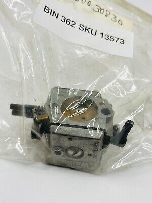

Anybody know the model number of the early cs 8000 carburetor?
Anyone know where I could find one of these larger carbs?
The saw definitely need a larger carb. I'm like 4-5 turns out on the high jet and I can't drop the rpms by setting it rich on the high jet. Way too small of a carb for 81 cc's of ported saw.

Just scored a new old stock hda 45 carb. It's the largest one for the old 1980's cs 8000p. No need in a ported saw breathing through a straw.

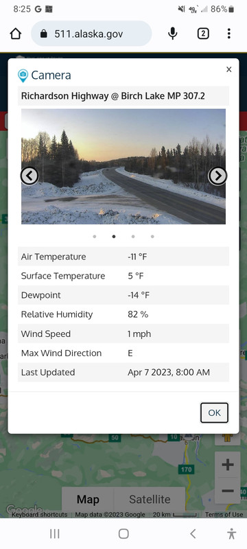

How's the snow pack down south? Ain't settling much up here. Still getting stuck on machine, trying to break trail to my next cutsite. At least the trail is set up like concrete today, still winter out there: 10-20 below zero at night.

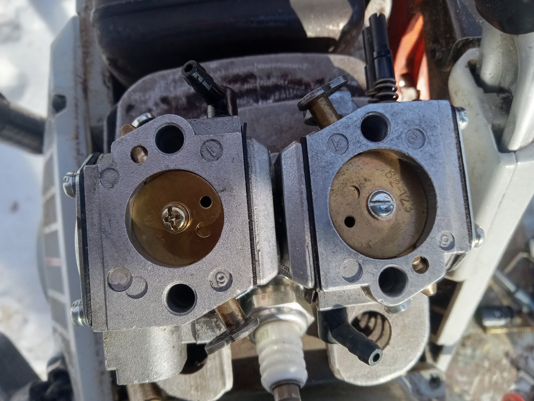

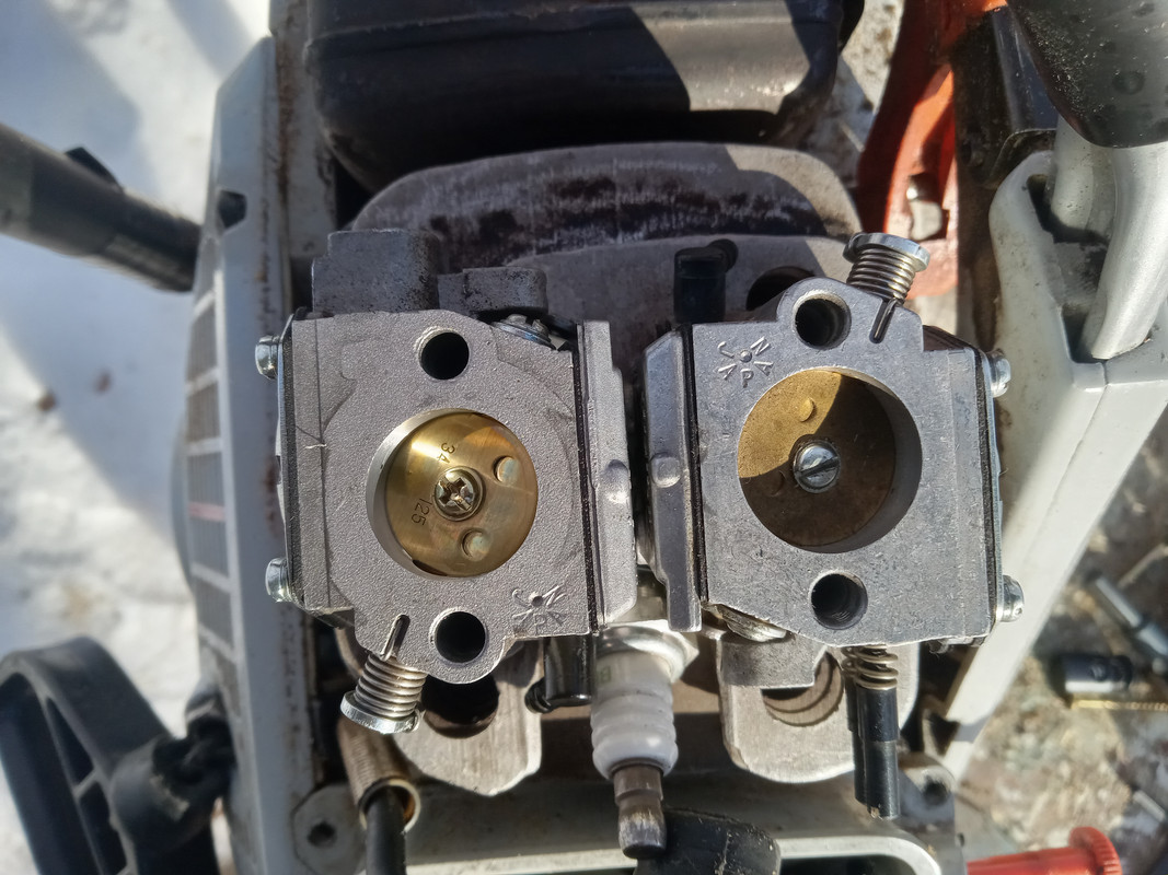

The two plastic carb blocks were slightly out of round from over-tightening the carb mount screws. The throttle and choke bore is so large on the hda 45, that both the throttle plate and the choke plate would hang up. Had to take it all apart, slightly burr-grind the carb blocks round and put a bevel on the surfaces closest to choke and throttle plates.
HDA 153B vs HDA 45:
Saw went blubbering rich 2.5 turns out on high jet, with the new hda 45. I could care less if the cs 8000 was quad port or dual port, but would never port another one of these 8000's without a good hda 45.
