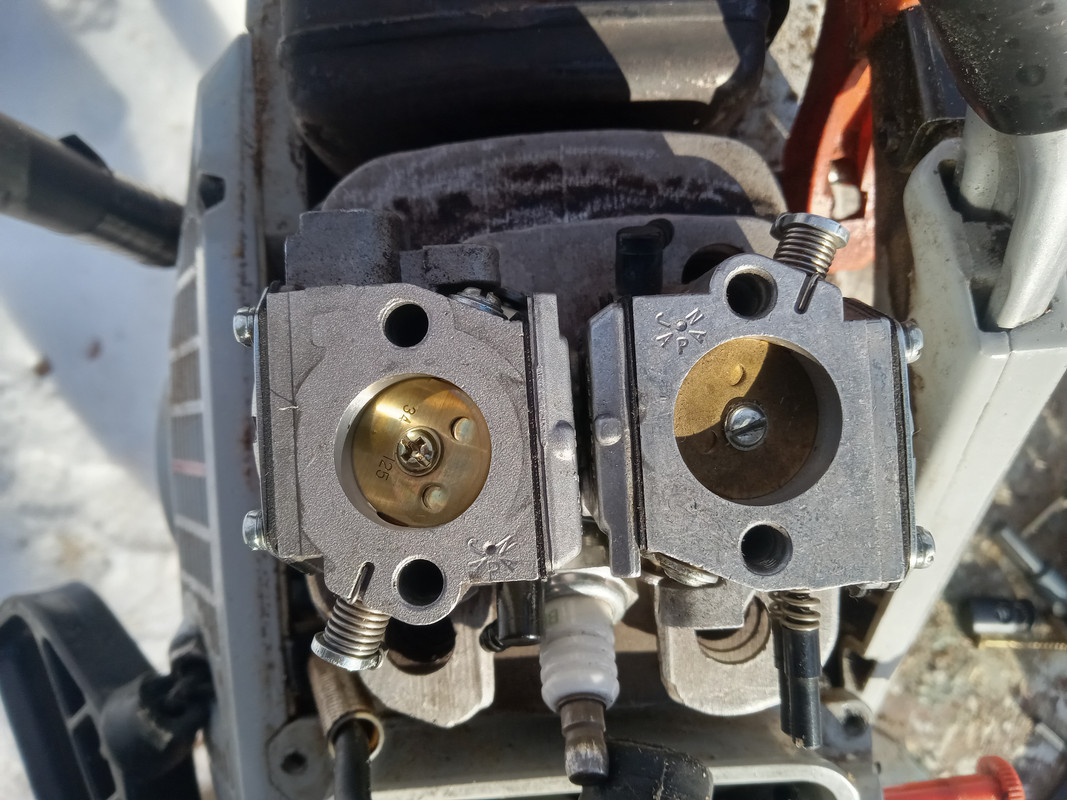

One of the most foolish things would be wasting a bunch of time porting the saw, only to breath through an insufficient carburetor and flapper filter.
The cs 680 filter setup is a direct bolt swap to the CS 8000. The HDA 45 carb is also a direct bolt swap and is substantially larger. The HDA 45 are as cheap as a Chinese aftermarket carb! I have a pile of em.

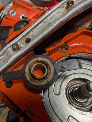

Ok guys, the clutch is catching at idle (3200 RPM) on my 500P but I can't figure out why. Any ideas here? This saw doesn't have many hours on it.

The only thing I could find was a bit of oily sawdust accumulation inside the clutch drum. I could hear something inside there grabbing and turning the chain but it was kind of a mechanical clacking sound. Before I took it apart, I started it without the bar and chain on and something was turning the clutch drum, in fact I couldn't stop it by applying pressure to the drum.

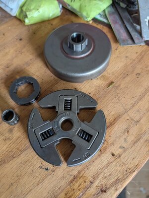

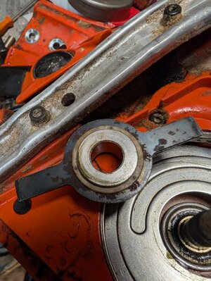

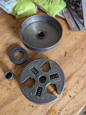

Ok, I think I've figured it out! See the flanged bushing inside the oil pump drive?
It is supposed to have the flange on the inside!
If you install it with the flange on the outside, the flange will contact the clutch shoes, thereby also turning the clutch drum! I reassembled it, and now it idles down to 2800 rpm without the chain turning. I don't remember ever taking that part out of the saw, but maybe I did at some point. Never too old to learn something new!
