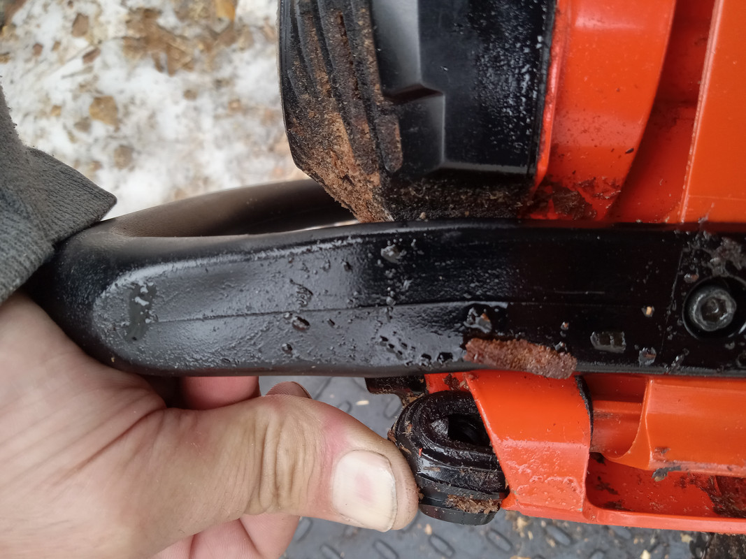

Ironic that both my cs 620pw has a cheap plastic chain brake toggle, which is broken. The cs 4910 has a torn rubber av mount. They're mighty thin.
Yet the flame torched $175 QV 6700 and the $150 echo cs 530 are ready to go, cutting nicely for the past 2 days. These used echos are a fraction of the price of my 620pw and 4910. Just because a saw is old-school, doesn't mean it's obsolete........

Happy Friday folks. I hope everyone is enjoying the return of summer. Just wanted to share my echo customer service experience.
Having no dealers here in interior Alaska, echo agreed to send me a new brake handle for my 620pw and new rubber av mount for my cs 4910. They'll allow me to fix the saws myself. And to think that I have another 3 years of warranty on these darn saws. Awesome company.
