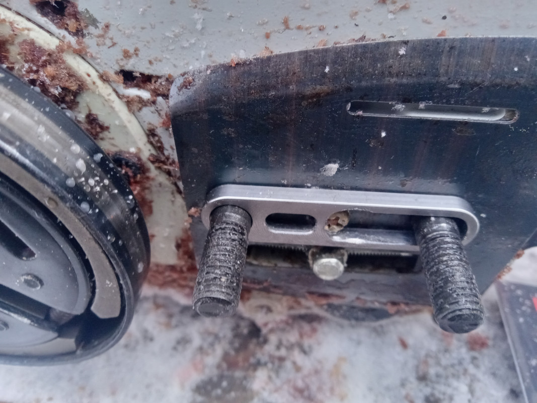

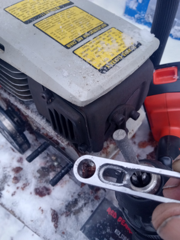

Gullet,
The redbeard adaptors work purdy good. Just have to polish a smidgen off for the barplate screw location. Though it was for the cs 620, it works with 670/6700/680 too.
I had to us an adaptor, so I could use a 3/8 low profile milling bar only available for stihl mount.
Yep, i agree with you, the 680 is not heavy or bulky. They balance well with a 24" bar. With that redbeard adaptor, a cheap $60 24" versacut bar and a $30 loop of EXL chain, they're a nimble/affordable chainsaw.

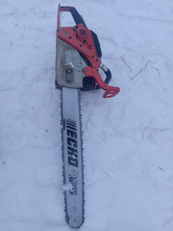

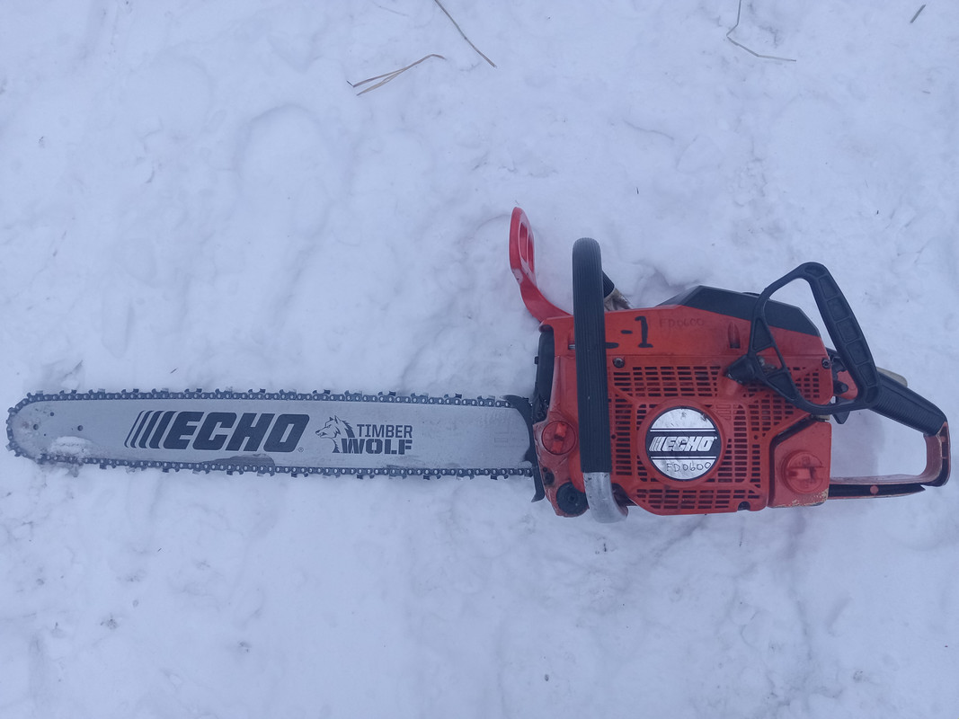

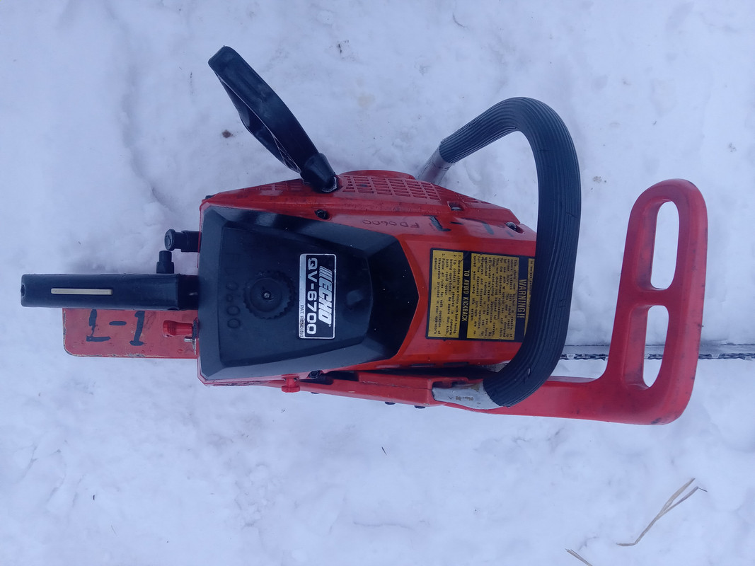

Finally finished that qv-6700. There were a few difficulties:
The screws holding the big steel guard on the saw was difficult to get off. The screws were really on there. Had to get into my stash of echo chainsaw screws, as the quick vent guard screws were too long.
The flywheel wouldn't come loose after many attempts. Almost gave up on ignition advance, but sea foam deep creep helped.
The piston pin was too tight. Had to heat up piston on wood stove and cool off pin. Even then, still had to knock it in place with hammer. It was the oem echo piston kit with bearing, clips, piston and rings for $75.
Lotta challenges and too many hours for a cosmetically rough saw.
Port work is a little different than my last 6700 build. Im surpised how different the carb settings were, just from slight port shape changes.
Surprised that it doesnt need new seals, impulse/oil/fuel line. It started first pull after reassembly, so carb diaghram is good too.

14 below zero, the saw cut well and started well. As the saw broke in, I began leaning it out and really pushing it. Could bury the entire 24" bar into frozen alaskan birch and it definitely has torque.

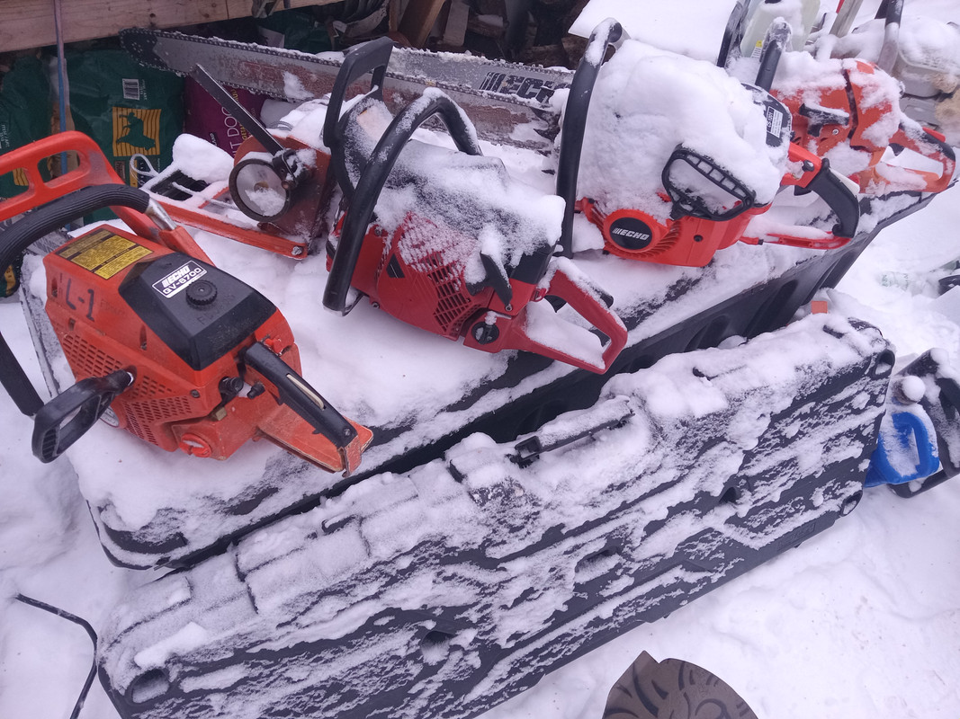

Spike, hello from Interior Alaska. Nice ole vintage thumper! Nothing brings husq & stihl guys together, like an echo chainsaw. Always fun to adventure out of the "brand bubble".
Question: would you happen to know of a heavy-duty clutch cover for my jonsered 2172? I've cracked 2 of the dmn things. Clutch covers as thin and frail as an eggshell. It's been banished to the lewis winch:

Take those damn saws INSIDE DANGIT!
Your KILLING ME! Lol

Hello up there in Alaska. Those frosty saws sure don't look they're in Florida. Do they need some extra coaxing to start in that weather?
The west coast cover from the 2188 is a little wider, but may not be much stronger. 572 covers fit also. Can always throw the huztl 372 covers on there. They're so cheap you can't get too upset if they break. Any of the red covers are gonna be pricy. Seems like 50% more than the equivalent orange part in most cases.

Yep, lots of bizarre rituals for not only getting them started in constant below-zero, but running them too.
Smaller carbs are purdy sweet for cold weather starting: husq 266 se, echo cs 6700, echo cs 4910, echo cs 8000 etc.
Flywheel bibs for colder than 20 below.
2 stroke oils with 50 below zero cold pour points. Crank residual that turns to gum is hard on rotator cuffs and starter recoils.
Bar oiled thinned with diesel or ATF.
Starting against a chain break ain't happening.
The density below-zero air is a btch on first start-up. All saws die immediately, if u shut off the choke on high idle. So yah gotta intermittently pull the choke in and out a half dozen times, before you shut off the choke and go to low idle. Hard to do with stihl "one lever for everything"
For stihls: max flow filter kits ain't happening. You loose winter setting.
Some saws need extra carb heat off the engine cover. I do this with pcv hoses off the cylinder cover, routed straight to carb cover.
My 2172 doesnt need extra heat, heated carb.
Porting for too high of rpms,they run like sht in the below zero. Moving too much air. I keep exauhst port lower too.
Port work: Keeping upper transfers lower, and moving the torque lower is better. 30 below frozen birch, high chain speed just skips and chatters, no matter the raker depth. Lots of moisture, and small growth rings.

I'm calling the Alaska Chainsaw Conservation Agency on Monday.
Filing a "Cruelty to Chainsaws" complaint.
No worries, its prolly just a ticket & fine.
