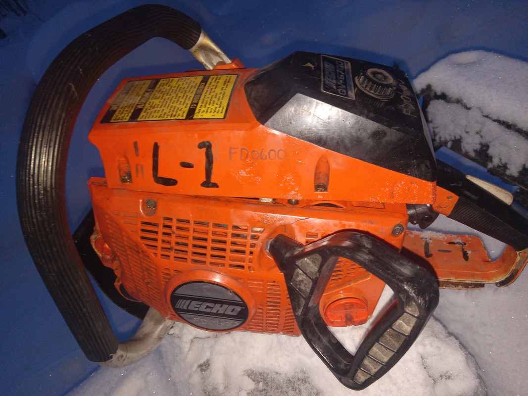

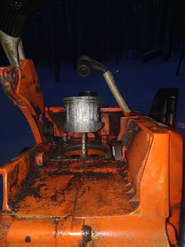

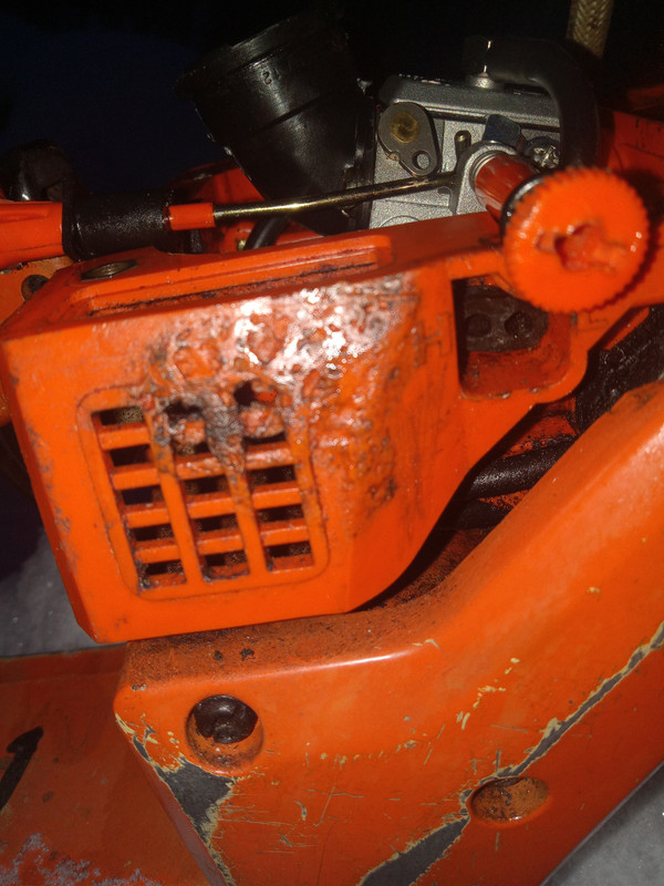

Just tore down a non-running qv-6700 rescue saw.
It was overheated. You could see where flames melted the side vents. The rubber plug for winter setting was also missing. The clutch cover was burnt.
When the older style handle-attached chain break was broken off, they simply replaced it with a newer style one.
Removed the cylinder, piston had rubbed off only near the exauhst port and seized the rings. The muffler screen was melted, probably from scavenging flames from a house fire.
Cylinder looked horrible, all around the exauhst. After some careful scraping and honing with 220 grit using sea foam deep creep, not a SINGLE gouge through the plating. Gawd, Echo had some THICK plating on these brutes. Un-fkn-believable!
Saw will only need a piston and rings.
Cosmetically, its rough, but it has character and a story. It probably saved lives. I pulled out some chunks of vehicle and asphalt shingle out of the fly wheel fins. I bet in a last-ditch effort, they must've used it to cut into cars in order to save someone. They weren't designed for that, so many of the handle screws were loose, from the vibrations of cutting metal.
Many of the carbide teeth were missing from the Echo Quick-Vent chain.
Looking forward to giving it a good working retirement, as a firewood saw. It's just gettting warmed up, even though it has been flame-treated:
