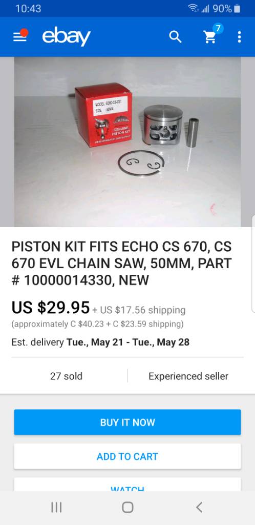

Want some opinions on pistons. I ordered an oem cylinder for the cs 670 of my sons. An oem piston and rings is 95 at dealer. Question is thers also an aftermarket on ebay that is a little less. Oem has 2 rings aftermarket has 1 ring.
I like going oem but wanted your opinions.
7:02 PM
Joe @Red97 might know?

In my limited experience with aftermarket pistons the rings are usually crap. By crap I mean gap was way off. So figure another $8-$10 for a caber or factory ring. Probably best just to go with factory as you mentioned.

I stopped today and ordered the new piston kit for the 670. That should be in next week and hopfully the cylinder follows shortly after. Ebay says it just cleared customs. Usually within a week from that it comes.
