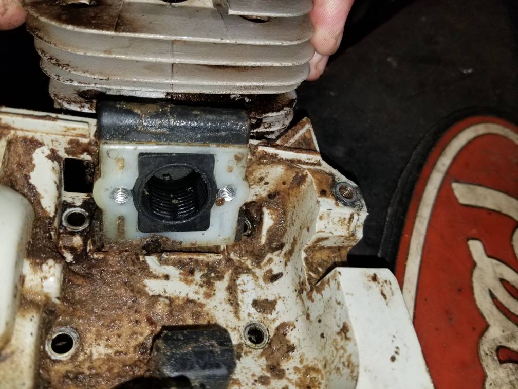

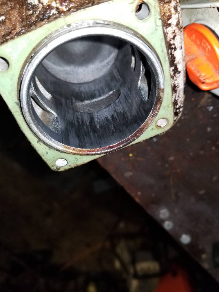

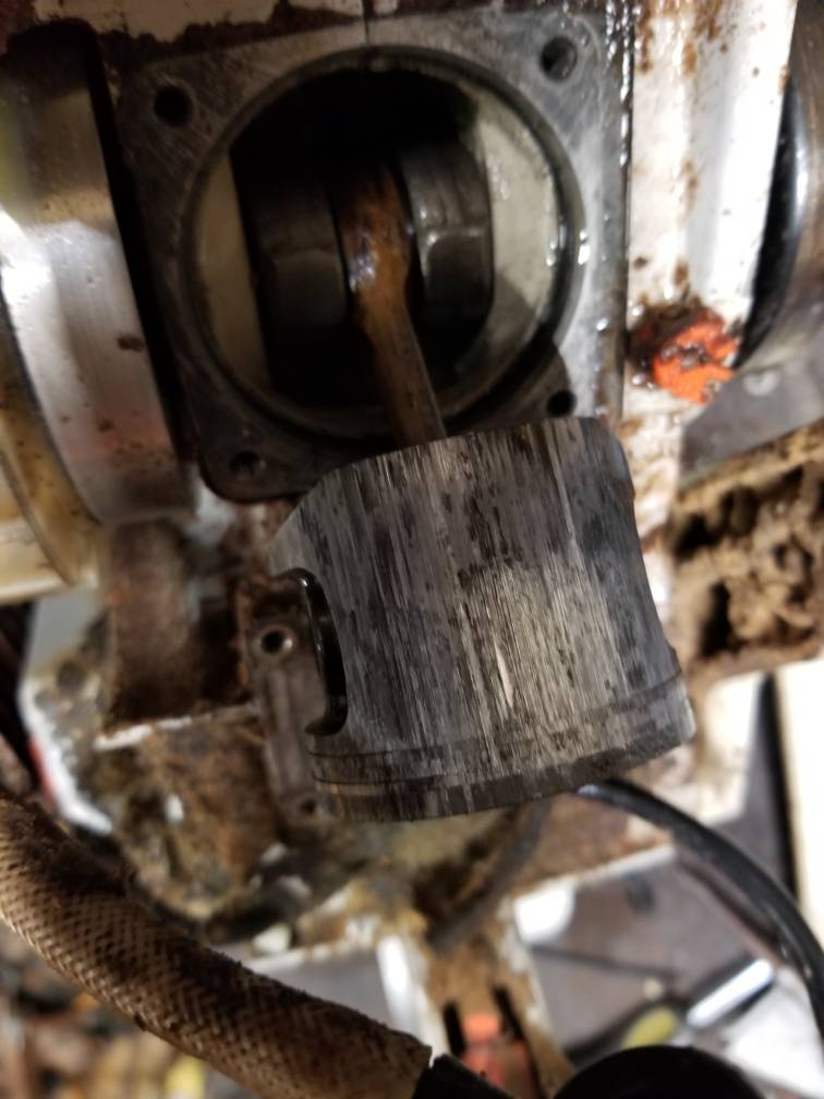

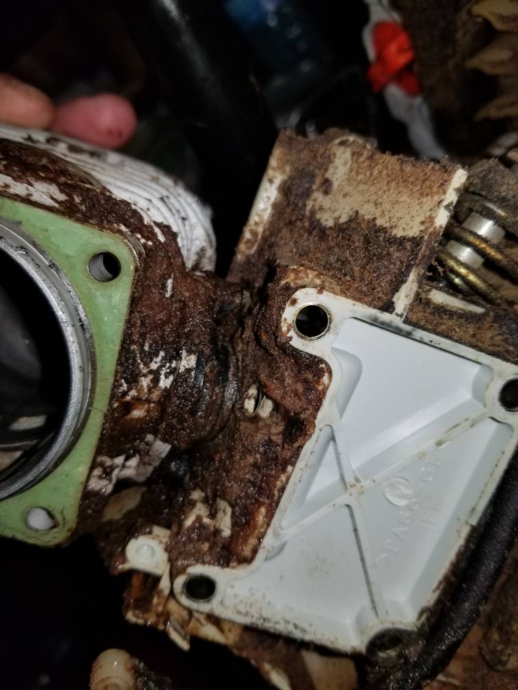

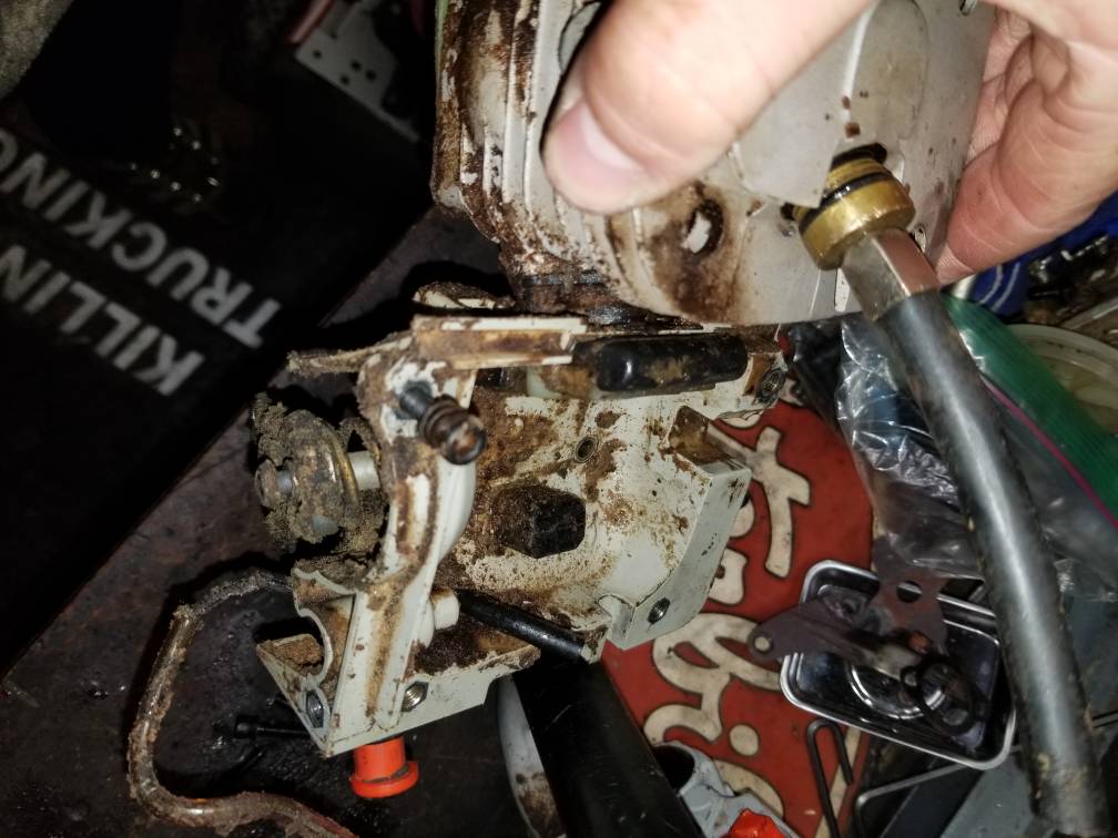

Well working on my sons saw. He just got it yesterday. He kinda got screwed on the deal. Add said it just needed a carb clean. I was working and couldnt go or it would have stayed ther. Any how it looks to be a straight gass victom. It holds pressure. Couldnt check the vacuum as my mity vac needs a rehuild and wont hold vacuum but will pressure.
Anyhow i ran out of time for today. Anyone know how the intake boot comes off cylinder. Thers two bolts at cylinder that are blocked by the plastic housing thing.
And also anyone posibly know of a good used piston and cylinder or price on new piston and cylinder.
Ouch.
What saw?
Man that’s ruff
