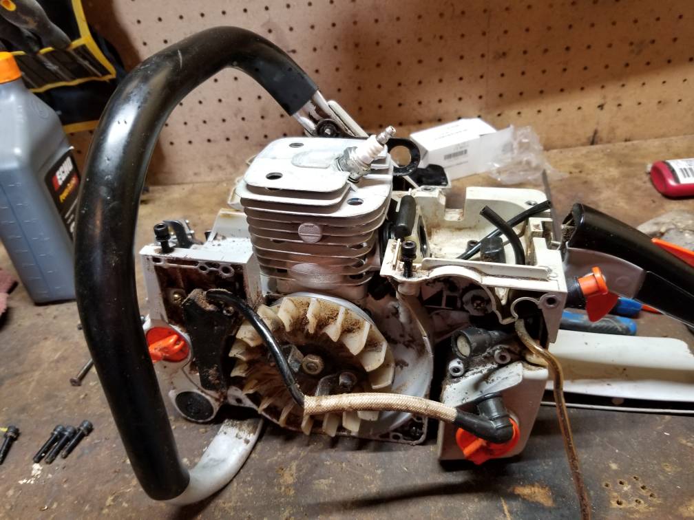

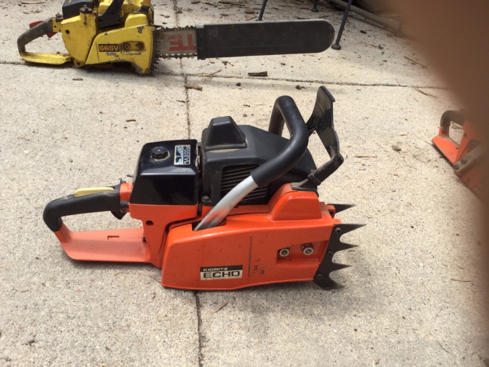

Got it togeather and a quick test fire. Hopfully test it on an ash log tomorrow evening. My son was pretty happy when he heard his basket case saw fire up.

Nice! That's the 670? Should be a great all around versatile saw.

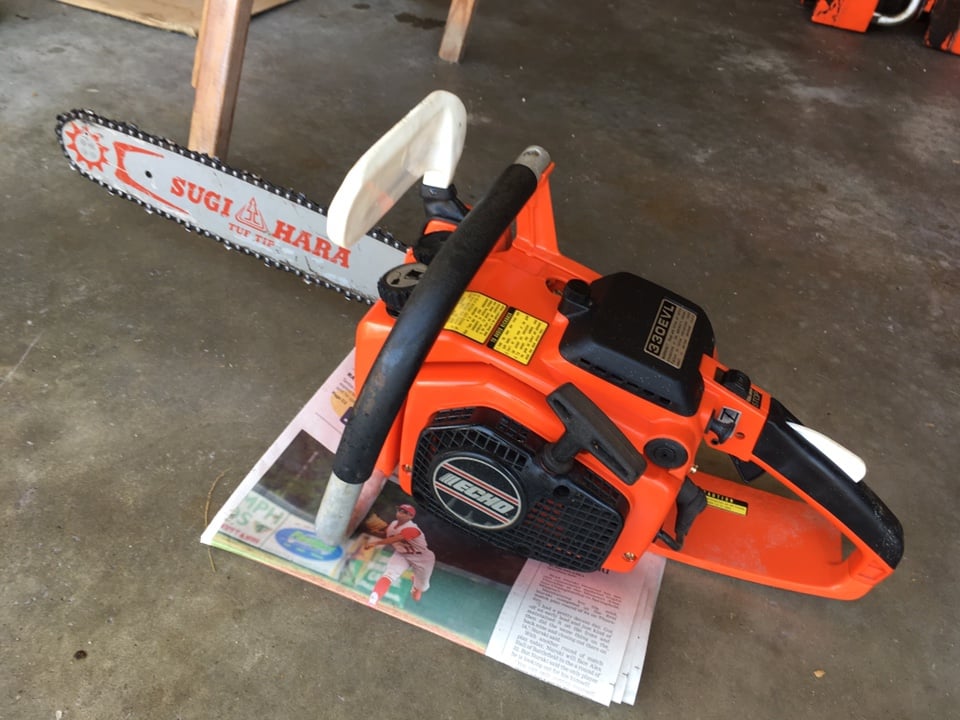

Finally got my 650evl cleaned up and together...here are the pics.
Just need to find a “Kioritz Echo” decal for the clutch cover.

Thats the 670.
I got it tore apart again. The fuel tank seam is leaking. I put some permatex motoseal on the seam so hope it works. Was a good idea for echo to make a tank that coms apart. At least it can be fixed. Now my son thought he would help and stripped the one screw with the wrong size philips screwdriver grrrrr. And try to get the screw out i broke a peace off the screw hole. Jope it works or he will be buyin a new tank.

A 2 piece tank doesn't sound like the best design in the world..... especially when Murphy's law is applied. Hopefully it seals up and starts making wood chips.

I thought the two piece tanks were a thing of the past....
Guess echo is a little behind on that.
