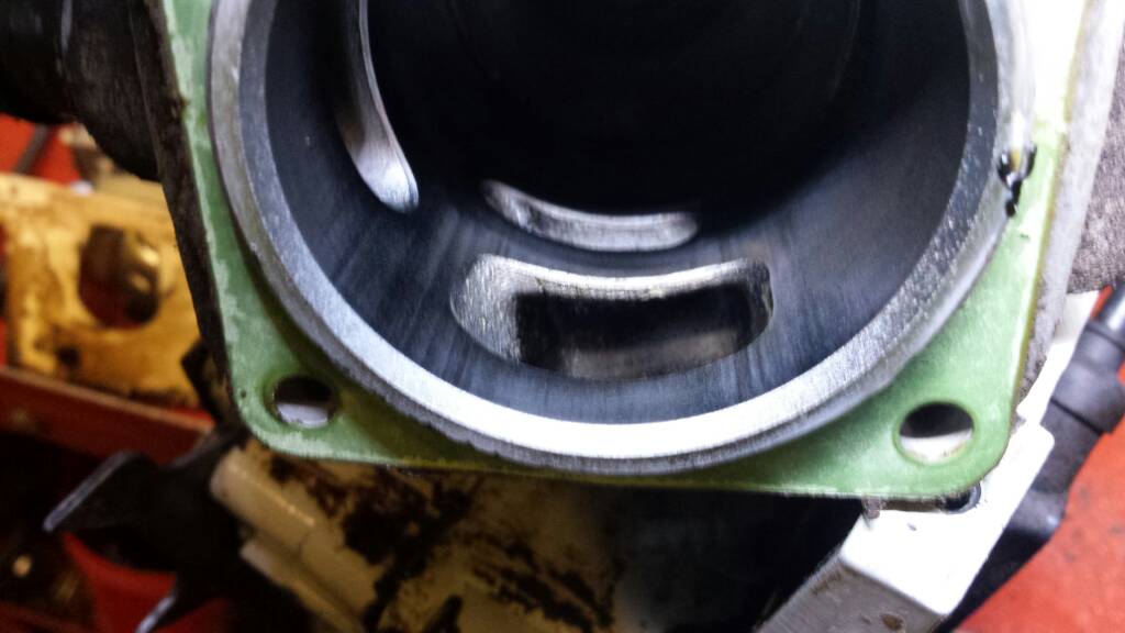

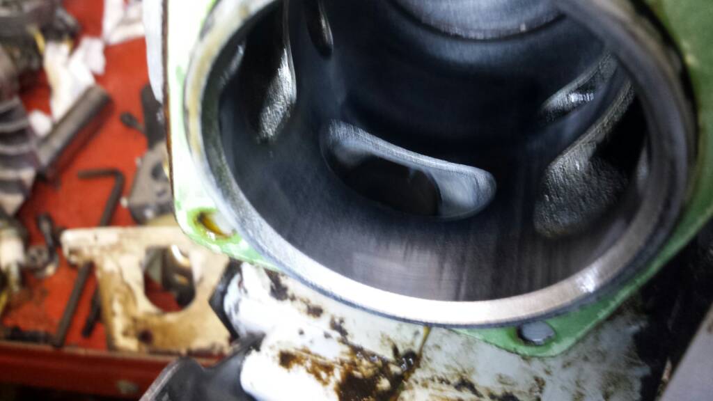

Welll.....after going in this thing and seeing what it's all about I know why these things are underated. I went lightly the first go around "little steps" changed port timing to what was mentioned and bumped compression. The saw ran very strong but seemed like it was hitting a Rev liter even dogging the saw real hard was still stuttering. So I tried to find a diff coil that would work but no dice. So I figured to I'm stuck there ...ready to give up I mounted a 460 carb on it to see what happens.....holy *s-word did that wake it up it was never the coil it just couldn't breath!it now turns 14500 without a problem...but I'm still not fully happy...it's apart now for a little more porting and a tad more comp. The one prob that is hurting is the ex port...the casting isn't thick enough to grind it as wide as I would like to go...but things are looking promising ...can I get it to run with a ported 390? I don't know but I'm trying...stay tuned:cool:

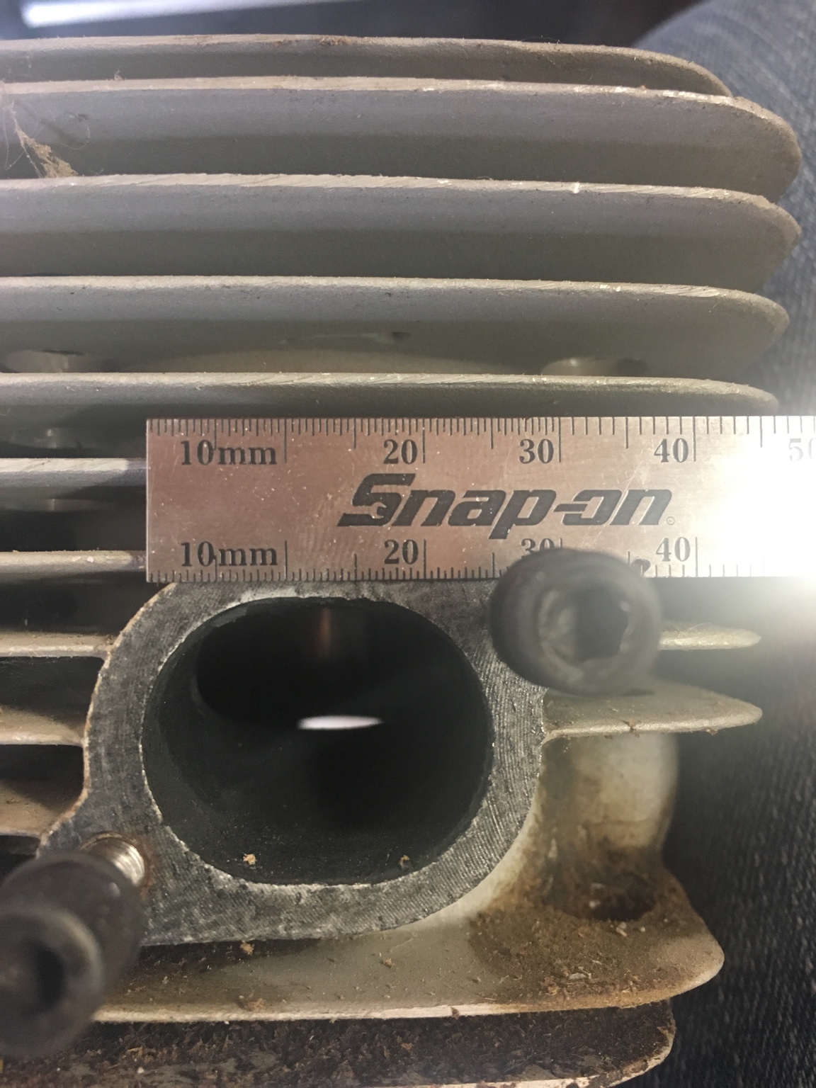

stock intake...I'll take more pics before I put it back together
