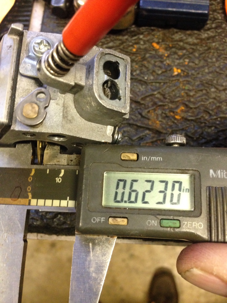

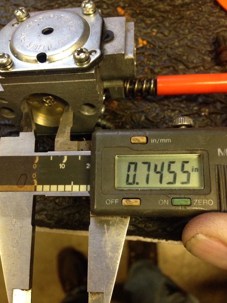

I just picked one up with a scored p/c. It has a HDA153A carb on it which looks real small. Will be looking for some parts if anyone has any laying around!

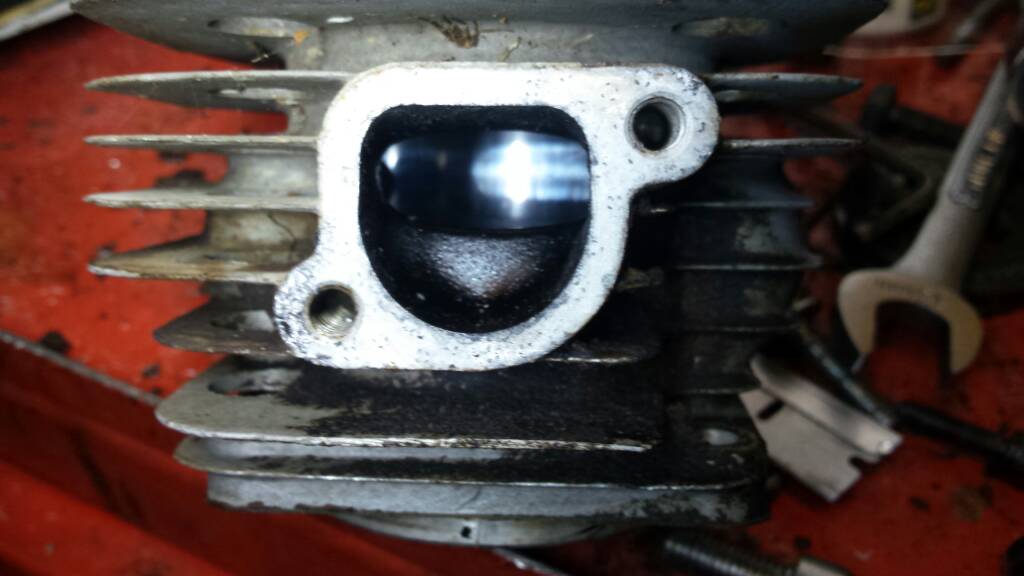

stock ex port....wtf!
Sent from my SCH-I545 using Tapatalk
Stock exhaust port looks like a easy pipe fit

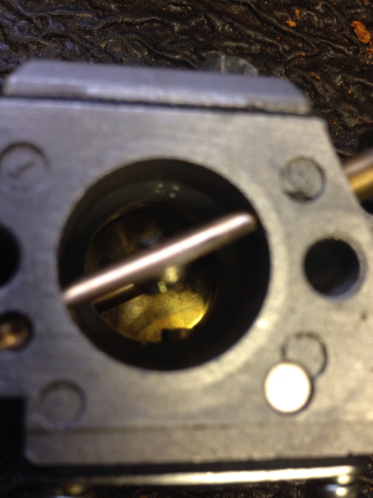

Send me a pic of your carb looking down the bore from choke side. Might be a cheep fix

That is a husky 136 carb. It was a accelerator pump carb. I made it for a echo 330T 360t drop in.

I'm with you now.
